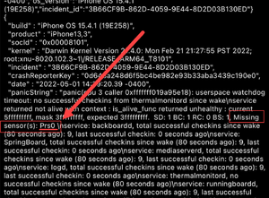

Before you start blindly replacing parts, it's important to try to confirm what is causing the restarting issue by reviewing the Panic Log file. This is a file that is generated by the Operating System, to document the fault causing the restart.
To find the panic log on the device, go to Settings-> Privacy-> Analytics & Improvements-> Analytics Data-> Scroll down to the files starting with "panic-full..." & click on the most recent dated file.
Then you'll want to scan through the text for keywords that may point you to the cause.
For this model, look for where it says "Missing Sensors:.."
If you see:
- TG0B or TG0V - It's battery related:
- The battery is defective or has failed
- The battery connector itself is damaged, warped or broken
- Check the battery connector on the charging port flex
- The battery connector data lines are missing.
- Check the battery data pin (PMU_TO_BATTERY_SWI) for a diode mode reading.
- Prs0 or Mic1 - It's the charging port flex.
- Test with known good charging port flex.
- Check for damaged or missing resistors around the charging port connector
- Mic2 - It's related to the mic on the power button flex
- Test with a known good power button flex
- Check for pry damage on all the small components near the connector
Alternatively, you can use a tool like the iDevice Panic Log Analyzer, which will download the panic logs from the device & display them on the PC & give you suggestions to possible solutions. It makes it easier to browse the panic log file.
Also, check out www.PanicFull.com which allows you to upload the panic log file & have it analyzed for free.
Both of these tools just give suggestions, which aren't always correct, as there is no official solution list from Apple. So many solutions are just suggestions based on hearsay, rumors or just guesses.
For situations where you don't see the above examples, you'll have to read through the top portion of the panic log & try to decipher what could be the root cause. Look for keywords you may recognize.
