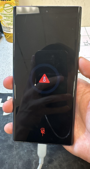

Samsung S22 Ultra has a common fault where it will give you a red exclamation mark warning when you plug in the charger.
If the device boots, it will say it's either very hot or very cold & it cannot charge & will shut down. This can happen out of nowhere. S22 Ultra also does not require the wireless coil/back cover to prevent the temp warning, like some of the older models do. A fully working S22 Ultra will charge fine without the wireless coil/back cover.
Samsung S22 Ultra with a temperature warning when charging
This issue lies within the motherboard itself

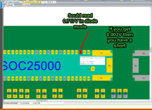

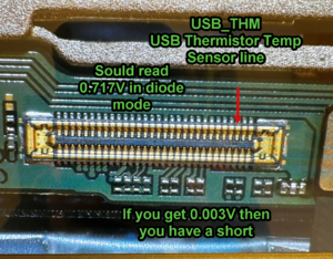

Samsung S22 Ultra - Connector Temp Sensor Line that you must check for a short.
Check the 3rd pin form the top right of the charging port FPC (SOC25000). The line is called USB_THM (USB Thermistor) which is the temp sensor line for the board.
The known good reading should be 0.717V
Samsung S22 Ultra - Charging Connector Temp Sensor Line Diagram.
If you get a low reading like 0.003V, then the line is shorted.

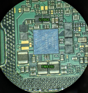

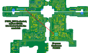

To repair the shorted USB_THM line, you must replace the U7002 IC. This is a PMIC inside the Samsung Sandwich.
Samsung S22 Ultra - U7002 IC that needs to be replaced if USB_THM is shorted
IC name is "Qualcomm PM8350"
This is extremely difficult to do, as the 2 layers are soldered together with lead free high temp solder.
