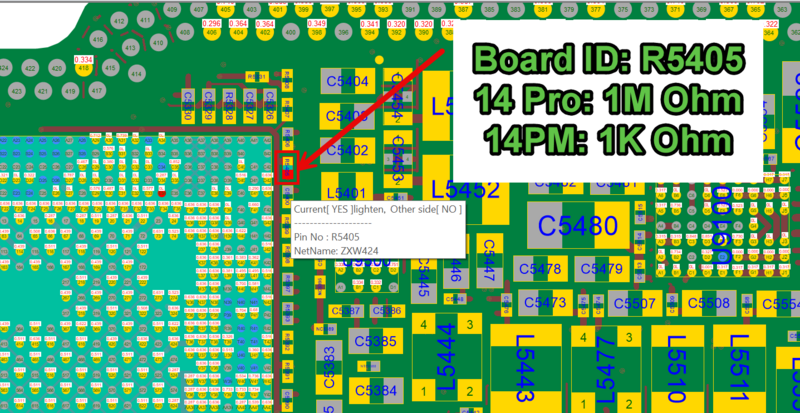

iPhone 14 Pro and Pro Max share the same top board, with only 1 resistor being different. This image shows where the Board ID resistor is located & what value it must be so it can be use for both iPhone 14 Pro and iPhone 14 Pro Max.
