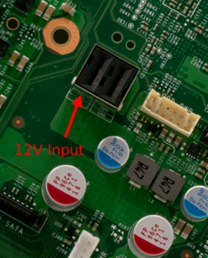

- The first thing to check is if the power supply is producing 12V, if 12V are not present this can be due to a faulty power supply or a short on the motherboard stopping the power supply from creating the 12V line.

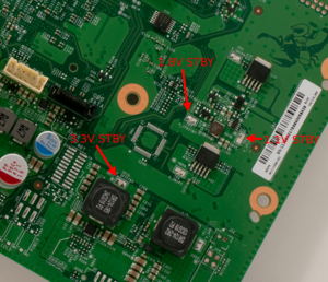

- If 12V are present the next thing to check is if the 5V Standby is present.
- If 5V is present the next thing to do check the 1.1V, 3,3V and 1.8V lines
- If these voltages are all Standby voltages are present the issue may be the Southbridge IC.
- If 3.3V is missing this may be due to a faulty U54, check for shorts around this ic made sure the 1.8VSTBY is present, the U54 will not turn on without 1.8V.

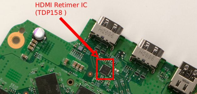

- A common issue to have is 2.4V on the 3.3V line, 0.44V on 1.8V the HDMI retimer IC is the cause for this, you can test it by removing it from the board the console will turn on and then off without the Retimer.

If 12V are not present remove the PSU in diode mode measure the Positive side of the PSU terminal on the motherboard it should have a high reading between 0.400 and 0.500, if ok replace the Power Supply.
If you get a reading of 0.000 it means there is a short on the 12V check the Short Circuits page on a guide on how find the short.
If 5V is not present on the Motherboard this is probably due to a short on this line once again with your multimeter in diode mode measure the line and check if the value is high, it is common to have a short on a random cap in this line, If you do have a short on a capacitor you check with schematics the value to replace it.
If 3.3V STBY is not present replace the U54 IC(TPS56C215)
If 3.3V and 1.8V lines are lower then expected replace the Retimer IC U29 (TDP158).

If you replaced the Retimer IC mare sure the console is able to output image in 4K.
