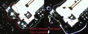

Examples of Poor Soldering
Ensure even joints that naturally flow into place. Proper soldering prevents clumps and incomplete joints.
Example of bad soldering (Figure 13)
Another example of bad soldering (Figure 14)

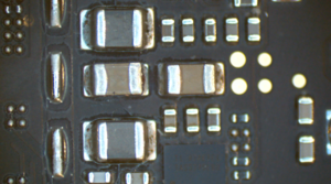

Can You See What's Wrong?
Here's an exercise for you. Can you spot the issue on figure 15?
Bank of capacitors. Do you see a problem? (Figure 15)
