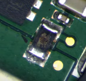

Example of blow resistor on a Surface Pro 4

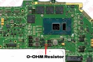

First, let's check the 0-ohm resistor. Below is an image showing where this component is located. Using your multimeter in resistance mode, measure the resistance, it should be 0 ohms. If you measure anything different, the component is faulty.
Surface Pro 4 Resistor Location

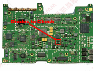

The next two components to check are the two diodes. Using your multimeter in continuity mode, ensure they don't have continuity across them. Also, verify there is no physical damage, such as cracks or holes.
Surface Pro 4 Diodes Location

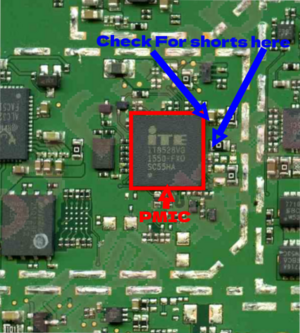

The next component to check is the PMIC. This component is commonly shorted. Follow the image below.
Surface Pro 4 PMIC
If one of the lines is shorted inject 1V with a DCPS and you will likely see the PMIC hot under a thermal camera.
