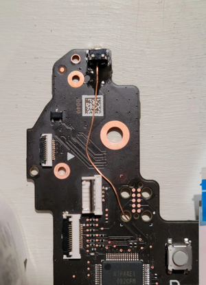

Figure 1: Example of a new shoulder button switch with a ripped center pad (picture by u/veazix).
A common problem with the controller board of the Steam Deck LCD are the shoulder switches, that can break off easily during disassembly.

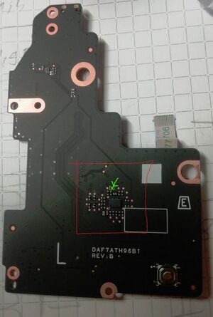

Test point of the L1 shoulder switch on the rev B controller board - full view
Figure 2: Test point of the L1 shoulder switch on the rev B controller board - full view. Red box: signal multiplexer. green arrow: testing point for the L1 switch.

Damaged signal pad
In case the signal pads on the pcb get damaged (See Figure 1):
On each controller board the leftmost and rightmost pin of the switch is connected to the ground plane of the board.

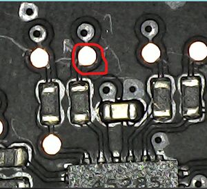

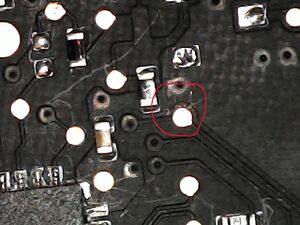

Figure 3: Test point of the L1 shoulder switch on the rev B controller board. red circle: testing point for the L1 switch.
The middle pin is connected to the MCU/a signal multiplexer. On the left controller board you can strip the solder mask of the trace, running to the middle pin of the switch or connect the middle pin of the switch to the corresponding testing point for the L1 switch (see figure 2 and 3 on rev. B boards and figure 7 on rev. F board).

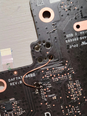

On the right controller board, the middle pin is connected to the testing point visualised in figure 4.
Figure 5: Controller Board R, magnet wire connected to the center pin of the switch (picture by u/veazix).
Figure 6: Controller Board R, magnet wire connected to the testing point on the back side of the board (picture by u/veazix).
A possible fix for the right controller board might look like figure 5 and 6 (rev. B Board) if you run a magnet wire (enamelled wire) from the center pin of the switch to the testing point.
