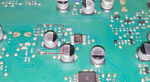

Capacitor with wrong polarity (Figure 1)
There is a design error around the AUX input circuitry: The Electrolytic capacitor that connects to the "IN-" input of TDA8579 is placed with the wrong polarity. This results in the electrolytic capacitor getting reverse-charged, even without the AUX interface being in use. The reverse charging happens via high value resistors, so it is unlikely to end in the capacitor exploding, but if you choose to make use of the AUX input, then the polarity of this capacitor should be fixed. Figure 1 shows the capacitor mounted with the incorrect polarity from the factory. It should be the opposite: The positive side should be towards the TDA chip next to it. (You can verify this both by measuring the voltage on the capacitor, and by looking at reference schematics of the TDA8579 chip.

Instead it would be better to use the AUX stereo connector, fix the incorrectly placed capacitor to be in the opposite orientation of Figure 1, and to enable the aux input using some car diagnostics software that supports enabling it. (the author of this paragraph has not tried the better modification yet, but is firmly against the advice found on the link above)
