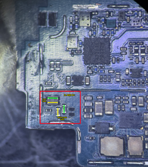

  • To Confirm the problem if its related to DP and DM lines you can use a tail plug tester and see if you get OL in the data lines.
  • Check diode value as shown in the picture
  • DP and DM should have almost the same diode value and this is true fro CC1 and CC2 aswell.
  • DP DM on Connector
  • If any of DP or DM line has lower diode value or OL you can reffer to this photo below
  • CPU TO MAIN CONNECTOR DP AND DM
    These lines can be bypassed with no issue. if you get any short line to ground it could be due to a bad cpu aswell(not fixable without replacing cpu)

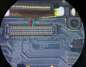

  • If after changing the connector problem remains the same try to change the screen(because main flex from sub board to the main board runs throught the screen) and try to change the sub board aswell.
  • If you do not have a screen and the sub board in stock then you can try to run the following jumper from the motherboard to the sub-board(to emulate a good flex)
DP DM on Connector

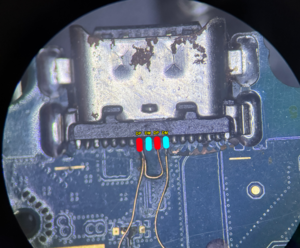

  • This is how to emulate a good dock:
DOCK DM DP
DP DM on Charging Port
