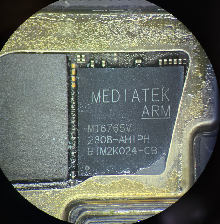

Typically, these are next to each other & very large chips. They also tend to have thermal paste or thermal pads. Sometimes they have shields completely covering them.
On this model, the CPU is labeled as MediaTek. So we can assume the other chip is the UFS.
Close up of A03s MediaTek CPU

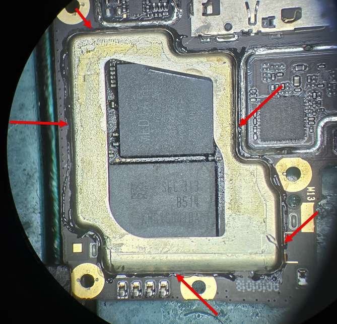

Now we must remove the shield around it to access the chips. I would recommend adding 138C Ultra Low Melt solder to the solder joints where the shield is attached to the board. Make sure to add plenty of flux & use a knife tip style iron
This will make removing the shield much easier
A03s Shield
A03s Shield where you must add flux
Using high temps, like 400C/60 air, heat around the perimeter
Use a hook tool or tweezers to grab onto the shield & pull it up, until it detaches, like this:

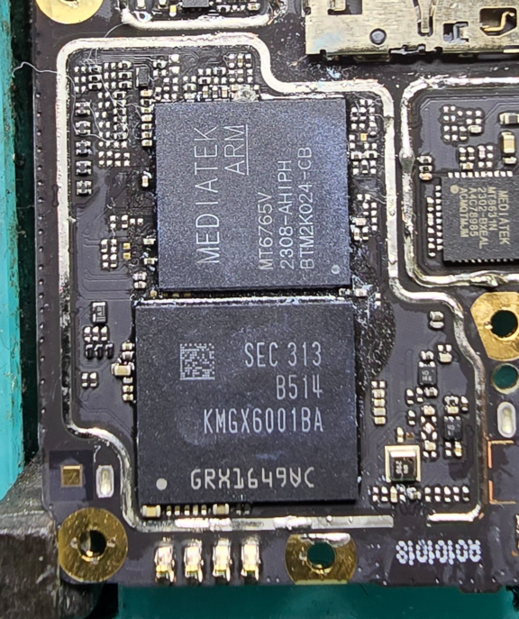

And now you have clear access to the 2 chips you need.
A03s CPU & UFS

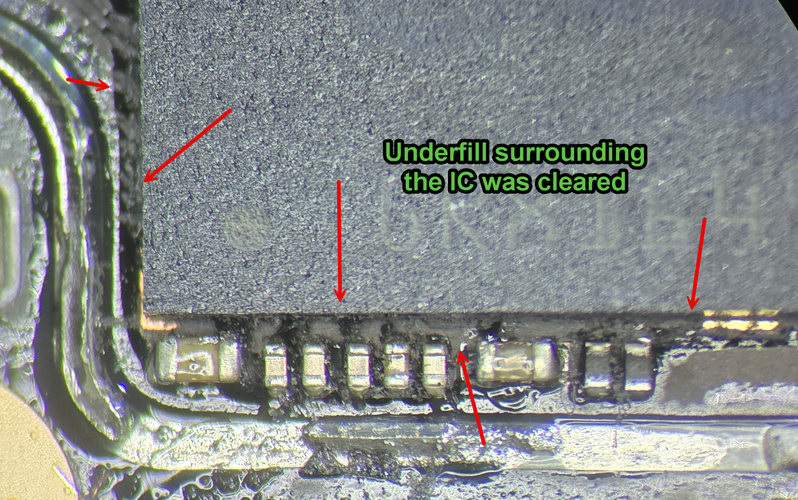

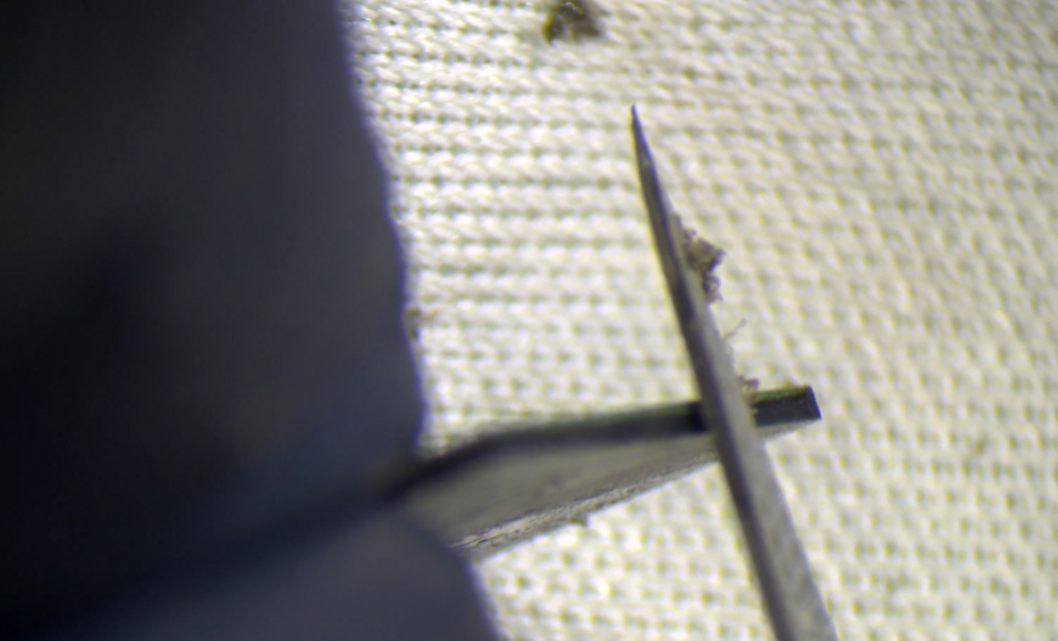

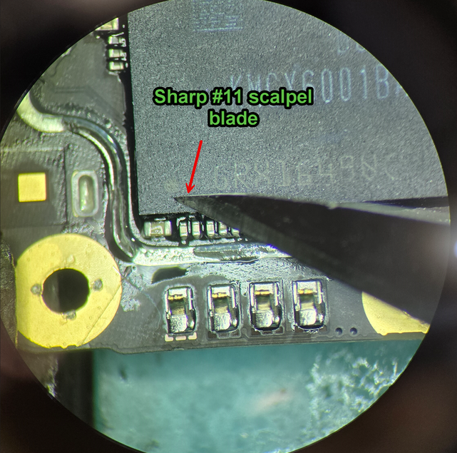

The CPU and UFS chips have hard & rubbery "glue" like substance that has these chips sealed to the board. This stuff is called "underfill". It must be cleared out with a sharp blade, like Scalpel #11 blade.
#11 Scalpel Blade
Go around all 4 sides of the CPU and UFS & get rid of it. This makes it so you can lift the chips easiest.
Underfill surrounding the IC was cleared

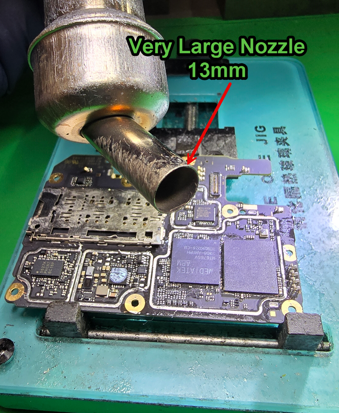

Switch to the largest nozzle your hot air station can support. For the Atten, we are using a bent 13mm nozzle
Large 13mm nozzle for hot air station

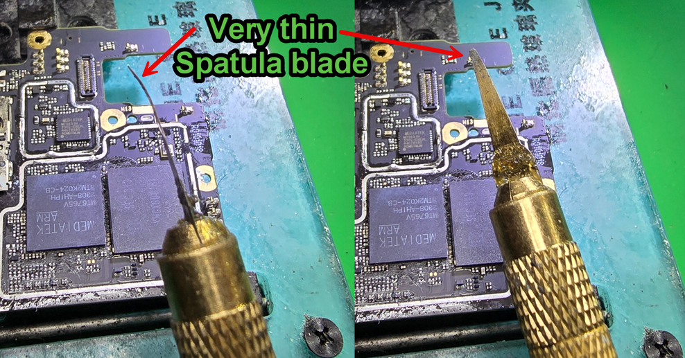

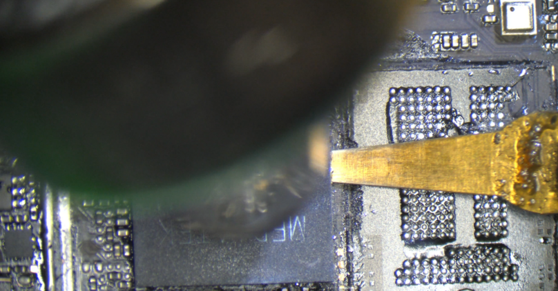

You're also going to need a very thin spatula blade. Use sandpaper to thin it out even further. Ideally, you'll want to taper the tip. This allow the blade to enter under the chip safely & cut through the underfill
Very thin spatula blade

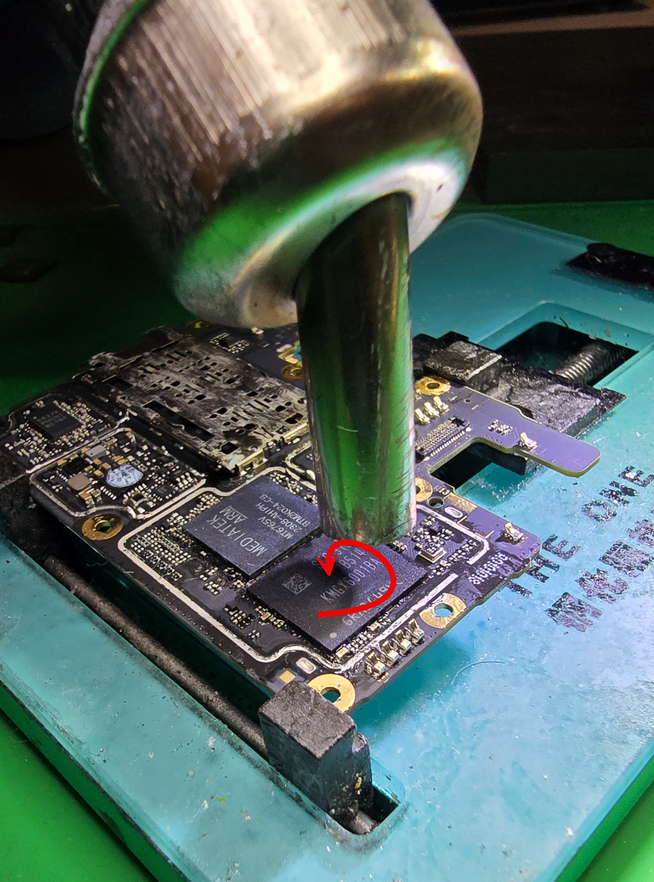

You'll want to use around 380C-400C to heat the chip in a circular motion. Make sure to start off far away, about 6in and heat in circles. This is to first warm up the board.
Over a 30 second period, get closer & closer until you're about 2-4mm away and always keep moving in circles.
Heat the CPU in circles
After about 30 seconds, the board should be very hot. This will make the underfill very soft.
Make sure to keep heating the IC in circles while still in close proximity.

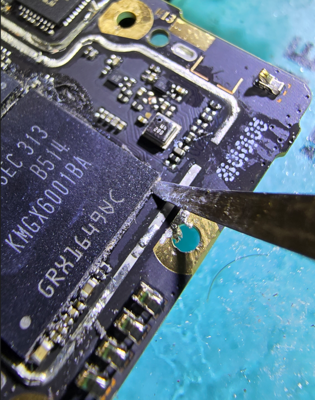

Find an entry point, where there's no components and gently try to pry into the chip. But only go in horizontally. Maybe a little angled to try to get under, but stay as horizontal as possible
If you don't feel it budge, then don't force it in. Although some force is required, there's a fine point on what's too much. This is where lots of practice comes in to know what proper force is
Spatula entering underneath the IC
.As the spatula starts entering, do slicing motions, in and out. But do it gently.

If you're not having luck entering under the chip, try turning your temps & air flow up by 10 points and try again.
Don't heat the chip more than 2 or 3 minutes at a time. Reasses the situation & see if you need to adjust your temps more. If your tool is too thick. If maybe there's a better spot to enter.
Whatever you do, do not bend the chip up trying to remove it. You can damage it permanently & lose all chance to get data.

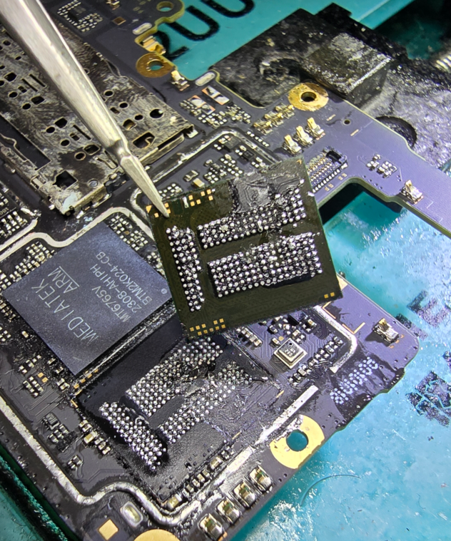

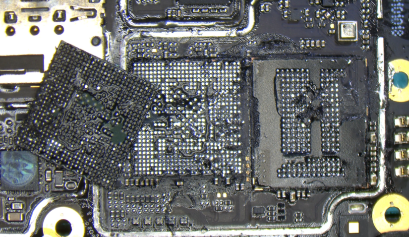

UFS Removed
Once the chip is removed, inspect it for any damage. Look closely for any ripped pads or any scratches on the IC. This is where most go wrong & damage the chip. In many cases, if the chip gets damaged, then it's game over.
Using a thin blade, we heat the CPU and gently slide the blade between the board & the chip
Then you'll have to repeat the same steps to ultimately remove the 2 important chips: CPU and UFS

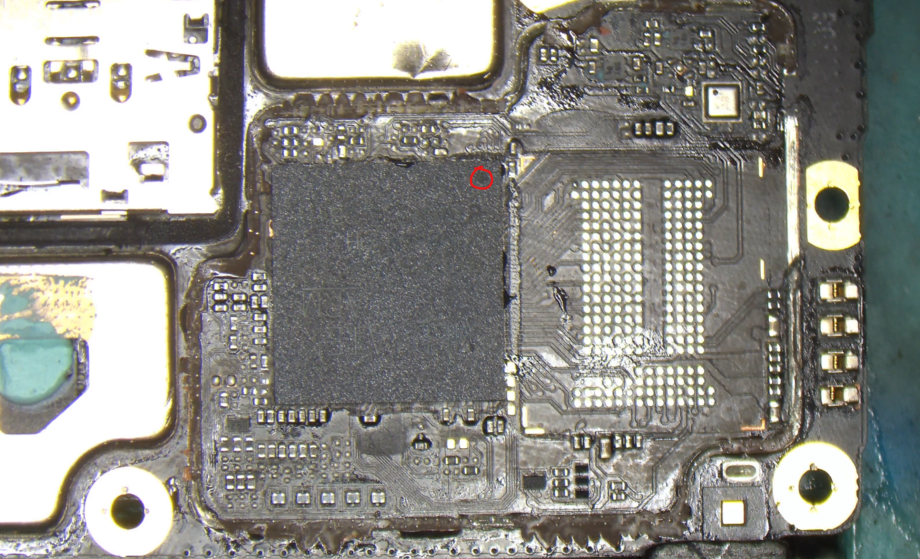

A03s CPU on board with UFS removed
CPU and UFS removed
Make sure to save these 2 chips. They are paired together & must be installed onto the working donor board. I would suggest to have a designated spot on your bench, like a small tin can or box, where you will always place the critical customer chips into, so you don't mix them up with the donor board chips.

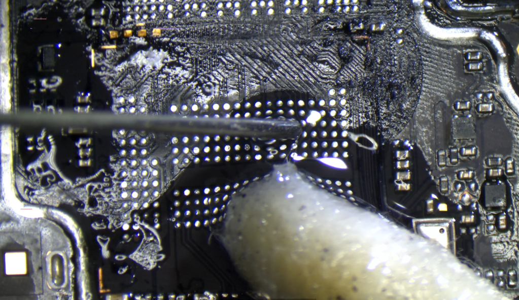

Wicking donor board

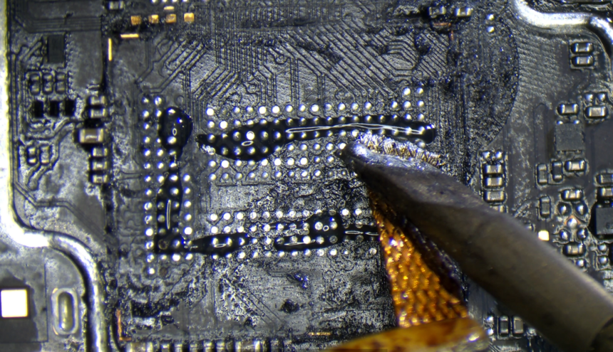

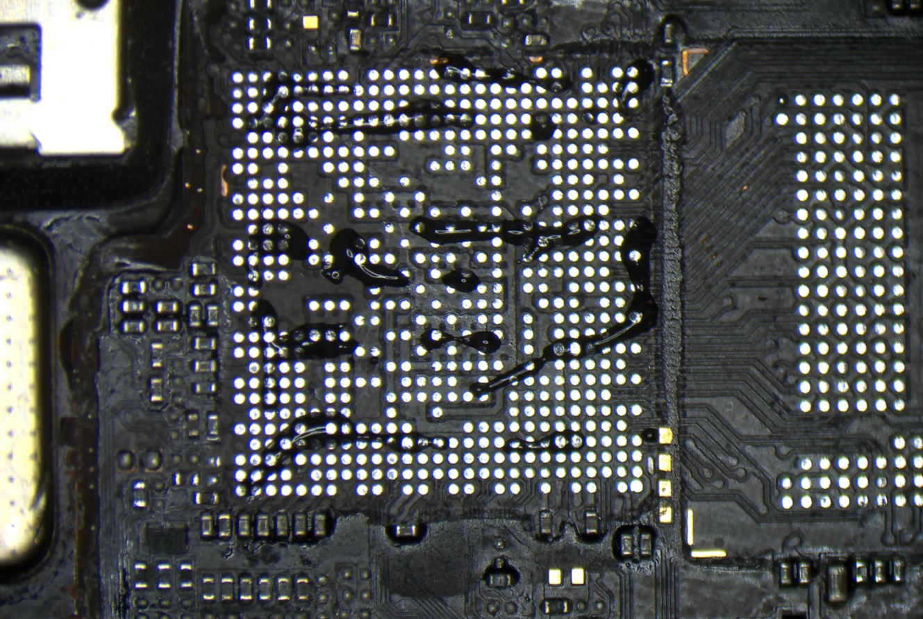

After removing the chips, we must prep the board.

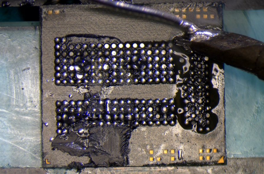

Using hot air at 250C / 40 air flow, pick off all the big chunks of underfill off the board. You can use your tweezers, scalpel blade or other pointy tool to pick it off. The hot air will soften it so it comes off really easy.
Then you want to add tons of flux on the board & run your iron with a big blob of low melt solder (138C), over all the pads. Make sure all pads get covered with the new solder.
Make sure to clean the board thoroughly with iso and toothbrush.
Now, add tons of flux again & wick all the pads flat. Then clean the board again.
Cleaning pads & board
Repeat this for both CPU and UFS pads. Make sure every speck of underfill is removed. This will ensure the chips sit evenly & flat.
Clean A03s board with no underfill

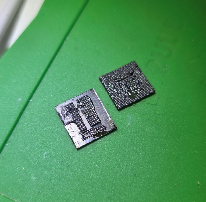

Next step is to prep the customer's chips: CPU and UFS
UFS Chip on micro jig
Use a jig, like the 2uul Micro Jig, to hold the IC facing up. As it makes it easier to work on the chip. We have to clean off all the underfill, prep the pads & wick them flat.
Prepping UFS pads
Add lots of flux then use 138C low melt solder to run over all the pads.
Then add more flux & do it again.

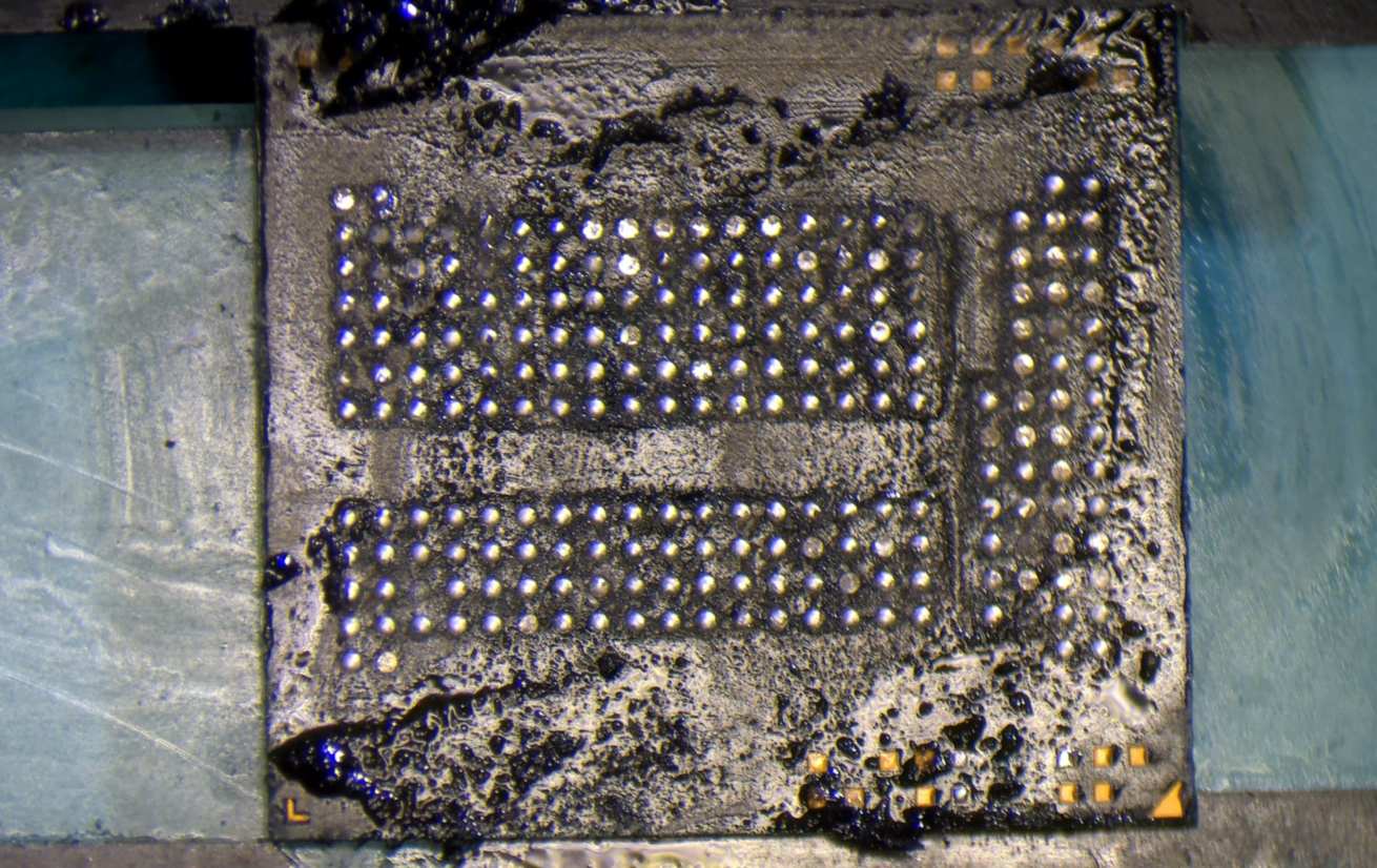

The goal is to clean off as much of the underfill as possible.
You can use hot air & a scalpel blade to pick off any small remnants of underfill, if necesary.
Removed a lot of the underfill
And make sure to clean off all the burnt flux regularly using iso & q-tips.
Wicking UFS chip pads
Lastly, you'll want to wick the chip flat. This allows for better results when reballing a large IC like CPU and UFS.
Repeat the same steps for the CPU.

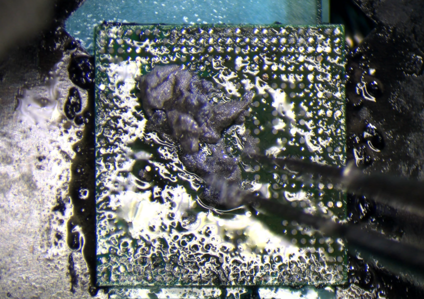

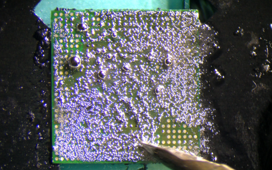

If the chip has a lot of oxidized pads (pads that are dark gray & are not taking in any solder), you can use try this trick.
Add flux & solder paste to the chip
Spread the paste on the CPU
Make sure to spread it across the whole chip
Hot Air the solder paste on the pads
Then use hot air to melt the solder at 320C / 25 air.

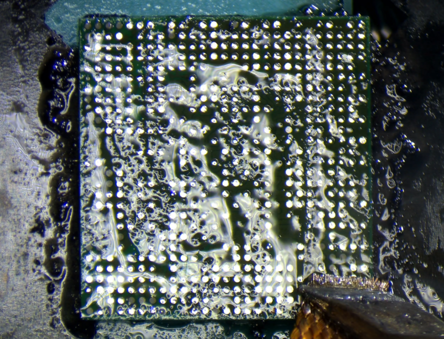

Once the solder paste has melted & turned into solder balls, you can run your iron over all the pads.
You'll see a bit portion of the oxidized pads are gone.
Wick CPU Pads
Then you can wick all the pads flat
And clean the chip with iso & a toothbrush

Once you remove the chip from the chip holder, you'll find that there's lots of gunk on the edge of the IC.
An easy way to clean all this off, is to use a scalpel blade and run along the edge of the IC. Make sure to do all 4 sides.

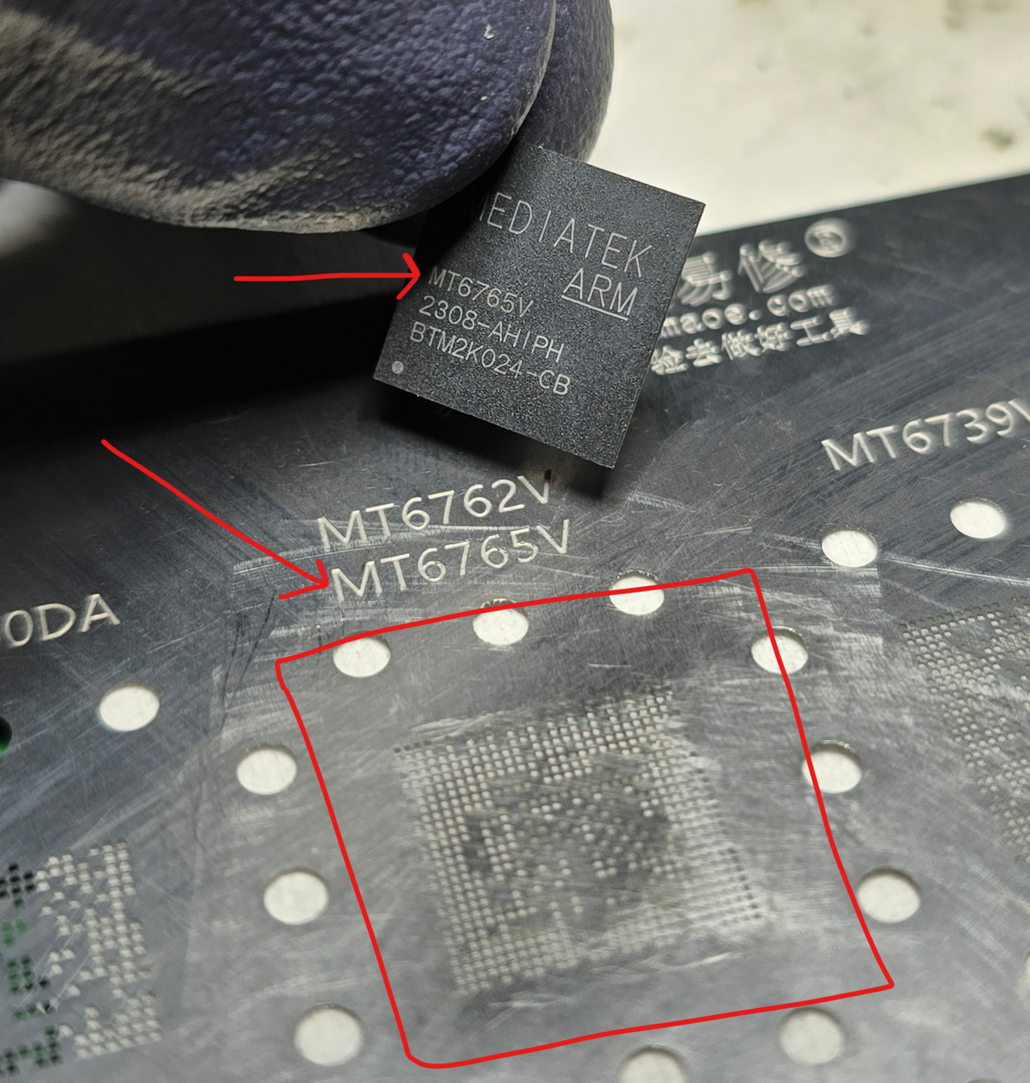

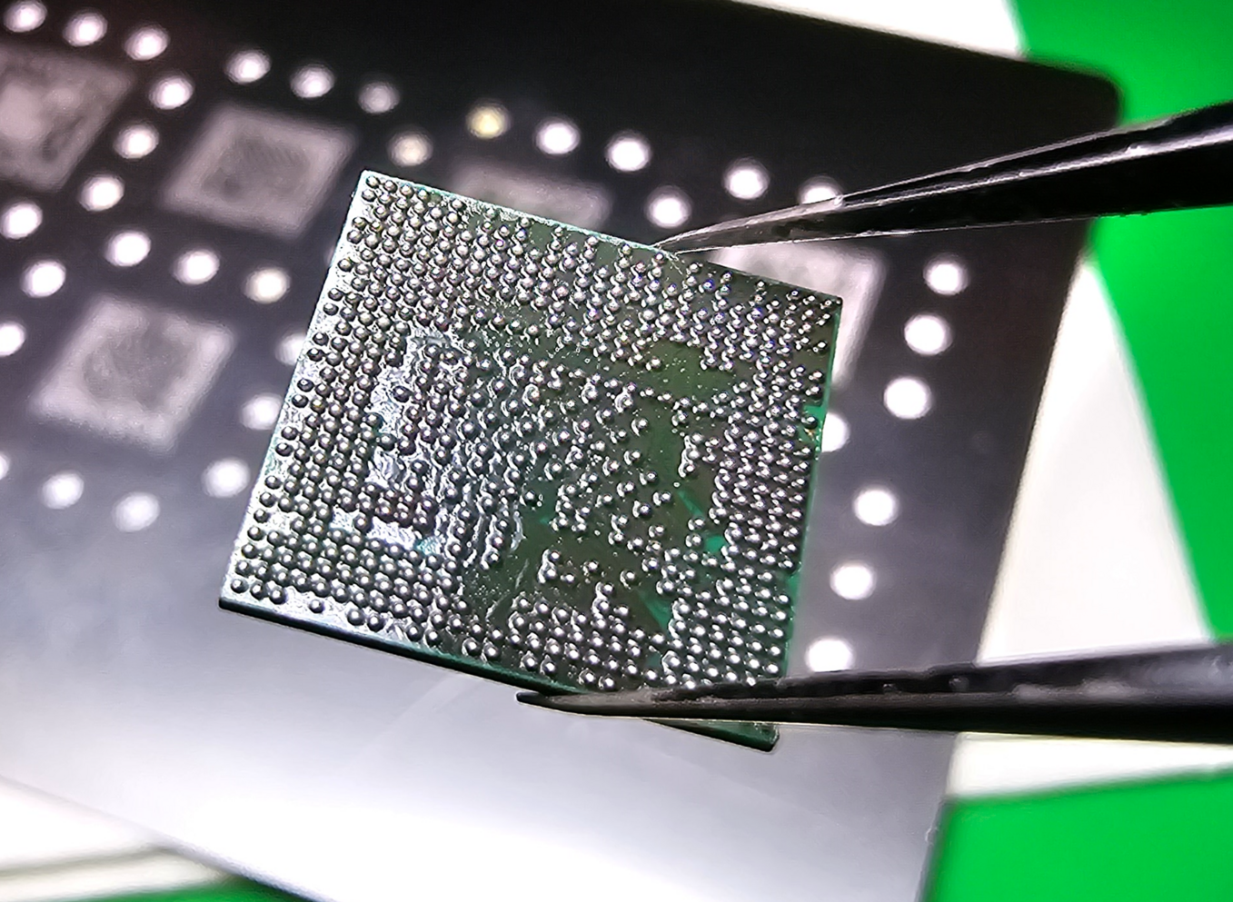

Once the IC is super clean on all sides, we can start the reball process:
MT6765V CPU and Stencil

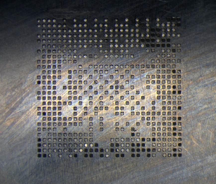

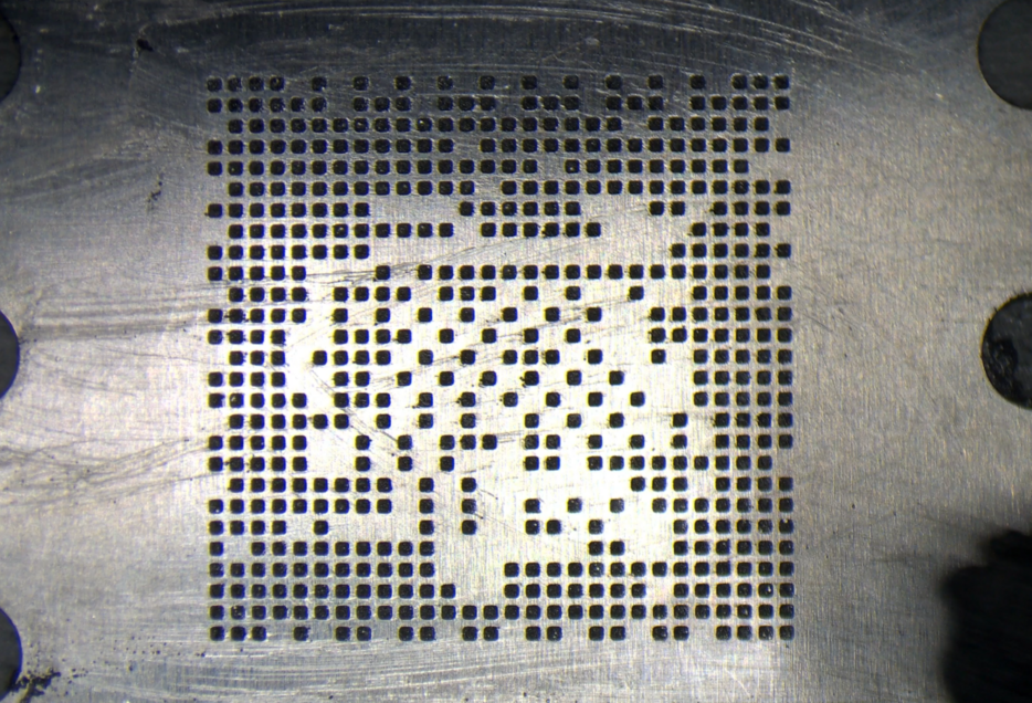

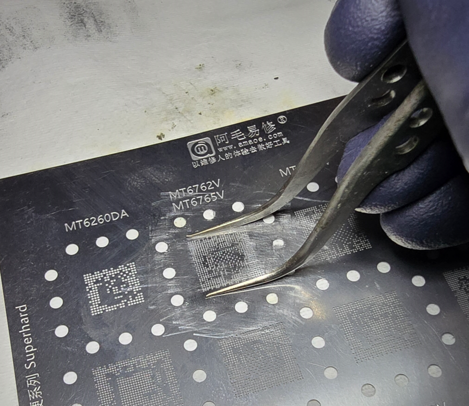

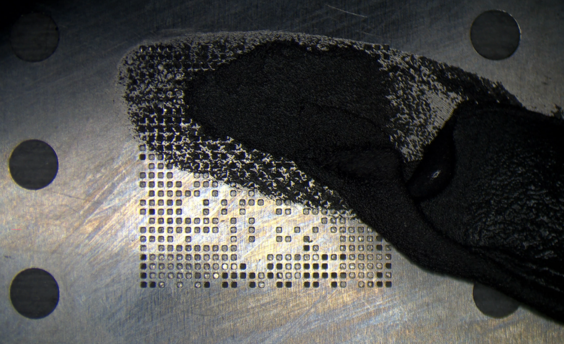

First, you need to have the right stencil. Best way to find it, is to search the CPU model number. In this case, we needed a MT6765V stencil.
CPU and Reballing Paste

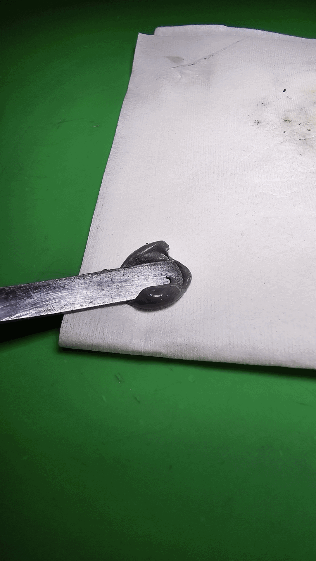

For CPU reballing, using Mechanic XG-50 183C paste works very nicely
Using a metal spatula, scoop up a small bead of paste, about the size of a pea.
Reballing paste on the spatula
Since it's very watery, you must dry out the paste so it can give you a better reballing result.
Paste drying technique
You'll want to get a clean cloth or paper towel & press the paste into it. You'll want to do this enough until the paste is more of a matte color than glossy.
In the end, it should look more like this:
Dried out reballing paste

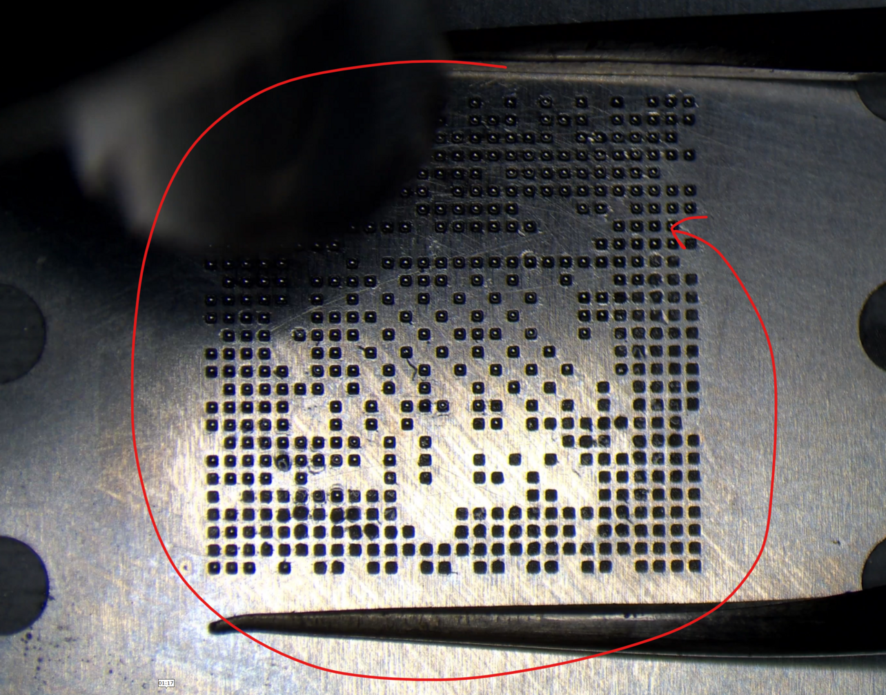

Now, you're ready to actually reball.
Place the IC on the clean cloth or paper towel, as this provides a soft cushioned surface for the IC, and place the stencil on top.
Make sure to line it up perfectly
CPU under the stencil
Using 2 fingers, press down on the stencil
Holding stencil down with 2 fingers
Then spread the dried out paste over all the pads
Spread the paste
Spread the paste
Make sure to fill every hole.
Do multiple passes over the whole chip, so the paste is packed into every hole.
Paste applied to the stencil
Then scrape over the chip with the same spatula, to clear out all the paste left on the surface of the stencil.
With a clean cloth wrapped around your index finger, wipe down over the top of the stencil. This will help pack in the paste even further & clean out any debris left on top.
Wipe the stencil down with clean cloth
Now, you'll need to switch out your 2 fingers to curved tweezers
Tweezers holding down the stencil

You'll then see the paste turn into solder balls.
Once all the solder balls are formed, you can take the heat away.
Wait about 5 seconds, allowing the solder balls to turn solid.
Then quickly pop out the IC from the stencil. Use the scalpel blade to poke it out.
CPU reball
CPU reball
Visually inspect the IC and make sure all the pads have solder balls & they all look even. If not, you can just clean the stencil & IC, then place the IC under the stencil again & just reball over the existing solder balls and get a "second coating" so to speak.

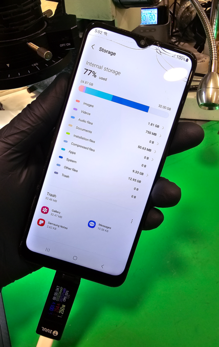

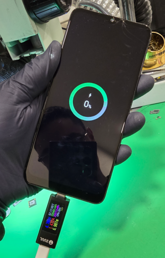

If all looks good, then time to test!
Fully reassemble & plug it into charge.
A03s charging
If you get a charging symbol like above
USB meter charging at 5V or 9V and 1A+
Then you're probably good!
Go ahead & boot up the phone & confirm it's able to boot too!
A03s Storage
A03s Storage
If it boots, then you're good to go!
It is recommended to run a Smart Switch Backup right away & get the data ASAP. Sometimes, these CPU Swaps can be unstable.
So don't risk it... get the data ASAP.
