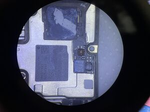

The device works fine, turn on and its fully functional but does not achrge at all and the charging is not even detected.
Symptoms
  • Phone works but does not charge.
  • Turns on with new battery
  • Diode value on main connector is ok
  • Charging is not detected in on state or off state

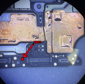

  • Measure diode value on the charging FPC connector
  • Check voltage on VBUS 5.0 volt
Check VBUS

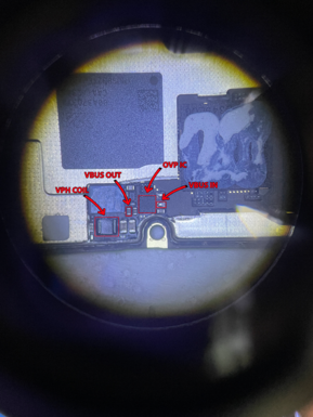

  • If 5.0 volt is present on the VBUS line then proceed to check the following components
  • Check if ovp ic is working:
    • Check the VBUS IN if is providing 5.0v
    • Check the VBUS OUT if its porviding the 5.0v output
OVP IC FUNCTION
  • If the VBUS OUT 5.0v is missing then proceed to the repair steps below.

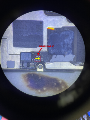

Repair Steps
  • Remove the OVP IC
  • Probe the pads to see there is no short to ground
  • if everything is ok then proceed to make a jumper bypass the OVP IC from VBUS _ OVP _ INPUT to VBUS _ OVP _ OUTPUT (shown in the picture below)
BYPASS OVP IC

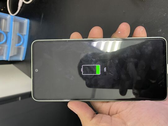

  • Test if everything is working
  • Apply solder mask and your device should be ready
Solder mask applied
Ready
