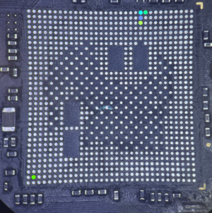

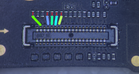

Generally in this condition there is the touch protocol line called TOUCH_SPI that gets damaged.
  • Check diode value in the marked pins,
    • You should get 0.500-0.700 diode value in these lines.
  • Missing resistor:
    • In the condition you got any missing resistor here and if its value is marked with 20Ω then you can run a jumper through
    • if the missing resistor has value 1K Ω (shown in the pic) then you will have to replace it with 1K resistor.
SPI
  • Here is the origin of these touch lines that come directly from the cpu(color coded to match the image on top):
Spi from cpu
