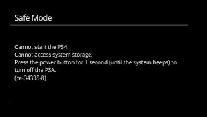

This happens when the console is unable to detect the Hard Disk.
Error CE-34335-8
Symptoms
  • Console Boots and displays the error CE-34335-8
