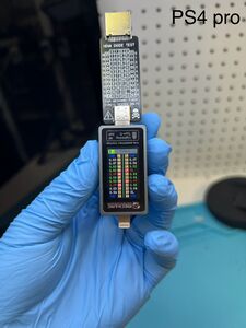

- If you have acess to the mozzwald HDMI adapter and a Mechanic Mechanic T-824 compare the readings of your port with a know good port.
