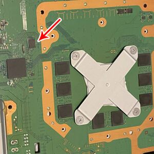

Remove the NOR chip and put it in your programmer using a WSON8 (CUH-12XX/Pro/Slim) or 16-PIN SOP (CUH-10XX/CUH-11XX) adapter. NOR chip will be located close to the Southbridge.

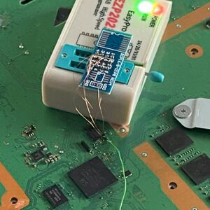

If you don't want to remove the NOR chip from the board you can use wires and solder corresponding pins from the NOR chip to the adapter board. In this case you don't connect the VCC pin of the NOR chip to the programmer. You need to supply voltage from a separate source by using a 3.3V power supply or a bench power supply.
It might be better not to remove the NOR chip as in some cases you will need to make further modifications to the NOR chip to fault find/fix your console. This will require to desolder the NOR chip multiple times which may cause damage to the board and the IC itself.
Location of the NOR chip on Playstation 4 Pro.
Reading Playstation 4 Pro NOR chip without removing it from the board.

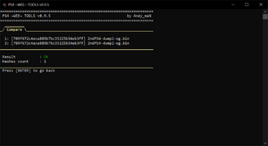

Read the NOR chip using a programmer of your choice at least 2 times and compare your dumps between each other to see if you're getting a consistent read.
Comparing dumps with PS4 Wee Tools:
  • Put the dumps in a folder and place that folder at the same location as the PS4 Wee Tools executable
  • Run the program and select option "1: File Browser"
  • Select your folder from the list
  • Use the "c: Compare files in current folder" option
This will verify whether both files are matching each other, if so you're good to go. If the check fails, go back, check your connections and read the chip again. This is especially important as the NOR chip contains per console information, if you lose that your console will be broken forever.
Be sure to name the dumps in a way where you will know which console they came from and what they have inside - for instance "2ndPS4-dump1-og.bin". As all the changes inside PS4 Wee Tools will apply immediately to the file it's good to keep a copy of the original dumps in a different place just in case.

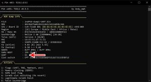

NOR dump with UART enabled in PS4 Wee Tools.
Now we will patch the dump of the NOR chip to enable the UART flag.
  • Copy one of the good dumps to the same folder as the PS4 Wee Tools executable
  • Select the dump you've just copied
  • Verify that the program successfully read information from the dump in the NOR info section (if so you have a good dump)
  • Select "1: Flags" option from the Action menu
  • Enable the UART flag by selecting option "1", you should see "UART was set to [On]"
  • Get back to previous menu using "0: Go Back" and then to the file browser using "s - Select Another File"
  • Select your dump again and verify that the UART says ON on the NOR info section
  • Close the program and rename your dump to indicate that it has the UART enabled - for instance "2ndPS4-dump1-UART.bin"

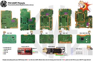

Connect to UART
You need to solder three wires to the board for the TX/RX signals and GND connection.
The diagram below shows where those points are on different board revisions:
Playstation 4 Fat/Slim/Pro UART pinout by BetterWayElectronics
Connect UART TX/RX and GND wires to the corresponding pins on your UART reader.
There are some boards on a diagram that only have UART TX marked, this is expected as for reading you only need to connect TX on one device (PS4) to the RX on another device (UART reader).
Once everything is hooked up, plug the UART reader to your computer, open PS4 Wee Tools and choose option "2: Terminal (UART)". Next, select your reader from the list. You will be presented with an empty console. Now turn on the PS4 and watch the magic happen.

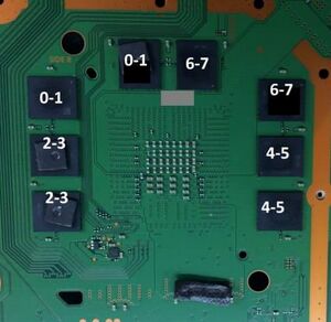

ERROR: DCT[#/#] is disabled
This error indicates a failure of a RAM chip block - a block consists of two RAM modules.
This error will appear if one or both of the RAM chips in a block have issues. DCT error is a communication error between the APU and the RAM modules, so replacing the RAM chips might not solve the issue if there's a connection problem under the APU.
There are 4 RAM blocks: 0/1, 2/3, 4/5, 6/7.
Playstation 4 Slim RAM blocks. This also applies for CUH-12XX PS4.
