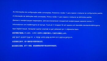

Console Turns on but after a few seconds it displays a blue screen saying "Settings information is corrupted"
Error displayed
Symptoms
  • Console Turns on but after a few seconds it displays a blue screen saying "Settings information is corrupted"
Solution
This issue is usually related to a problem on the LAN section of the motherboard, this can be caused by a damaged LAN Port, LAN controller (88E1118R-NNC2) or a short on this circuit.
