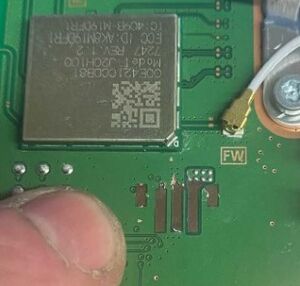

This can be something simple like a damaged fan FPC (a common issue) or a faulty Southbridge.

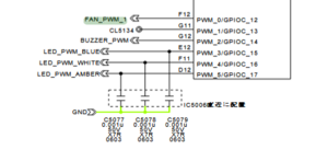

If there is no physical damage to the FPC, the next thing to do is to take diode readings of the fan FPC and compare them with the image below.
Since the console turns on, 12V is present, as the fan uses the main 12V line for power. Without this line, the console would not turn on.
If you get no reading at all on the PWM signal, the cause can be a crack in the PCB layer, a bad solder ball under the Southbridge IC, or a faulty Southbridge IC.
The fan PWM signal comes directly from the Southbridge CXD90061GG or CXD90069GG.
If there is a short on this line the Southbridge must be replaced.

If the FPC is ripped off the board, you must solder a new one. It is common to have the anchor points of the FPC ripped off the board. The best way to fix it is to use solder wick to make a base. You can follow this video made by Uber Micro Repair
