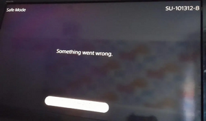

Just like the PlayStation 4, the disc drive in a PlayStation 5 is paired to the motherboard. When the PS5 cannot communicate with the Renesas chip, the console is unable to update the system firmware, resulting in errors such as SU-101312-8.
Error SU-101312-8

  • You purchased a disc version motherboard but are unable to reinstall the firmware.
  • The Renesas chip has failed.

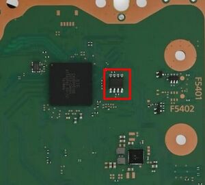

The BIOS chip (25Q16JVNIM) is located next to the southbridge.
Step 1: Remove the BIOS Chip
  • Locate the BIOS chip (25Q16JVNIM) next to the southbridge on the PS5 motherboard. Use a hot air station to carefully desolder the chip. Exercise caution and avoid excessive heat, as it can damage the chip.
