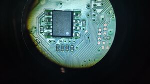

When ac power is plugged the console produces 3 fast beeps and the console does not turn on.
25Q16JVNIM Chip under microscope|alt=25Q16JVNIM Chip under microscope

This issue is related to the NOR (BIOS) IC.

The BIOS chip (25Q16JVNIM) is located next to the southbridge.
Step 1: Remove the BIOS Chip
- Locate the BIOS chip (25Q16JVNIM) next to the southbridge on the PS5 motherboard. Use a hot air station to carefully desolder the chip. Exercise caution and avoid excessive heat, as it can damage the chip.

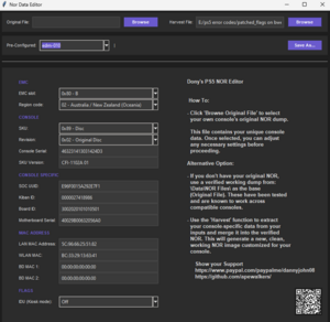

Step 3: Fixing your BIOS Dump
Using a free tool made by Dony this process is really simple, download PS5 NOR EDITOR
After downloading the tool, open it and click on pre-configured and select your board type.
After that, click on the browse button on the harvest section and find your dump a small pop-up window will show up and ask you what options you want to harvest, select all options and click on OK.
After that, save your file.
