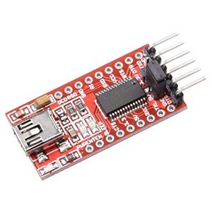

Example of a USB-TTL Device
Required tools
In order to connect to the PS3 you will need a USB-TTL device doesn't really matter which one.
You will also need a few pieces of wires to connect the device to the console.
You will need a soldering iron.

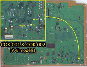

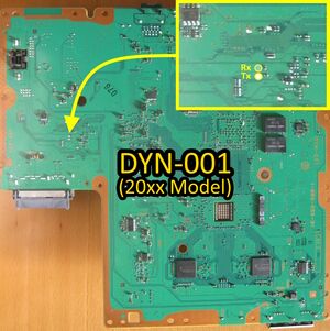

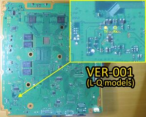

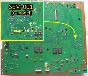

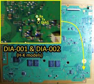

In order to connect the PS3 to your device you will need to solder 3 wires to the motherboard RX/TX and GND.
Bellow are the location of the points where we need to solder our wires, the locations vary from board to board.
Models A-E (COK-00X)
Model G (SEM-001).
Models H-K (DIA-00X)
Models L-Q (VER-001)
Model 20xx (DYN-001)
All Super Slim Models
Follow the image above solder your 3 wires to the test pads and connect them like the image above.
Remember RX goes to TX and TX to RX.

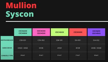

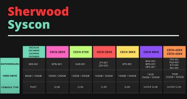

Then there 2 types of syscon on PS3 Consoles Mullion (CXR) and Sherwood (SW) select the correct one according to the images bellow.
Mullion Syscons
Sherwood Syscons
After selecting the right type of syscon click on Start.

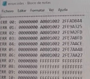

After a click on AUTH and wait for a green text saying sucess if you get fail multiple times keep trying and if still falling check your wiring.
After AUTH sucess click on Get Error Codes and wait for the process to finish.
Expected output:
PS3 Syscon expected output
