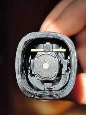

Bottom of the toothbrush with the cover and the small white bracket around the charging coil removed. Retention clips are on the left and right about 2cm deep

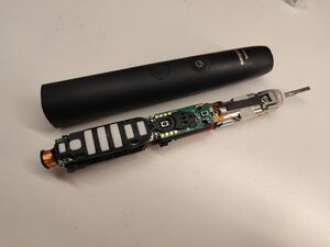

The insides of the device removed from its housing. The loose screw can be seen near the top of the device on the right
Tighten the philips head screw towards the top of the device. Test if vibration has been fixed.

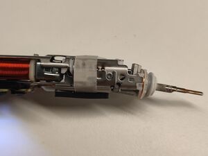

Vibrating part of the sonic toothbrush which has come loose due to the unsecured screw
The copper wire around the top is an NFC coil to detect the age of the brush head. Remove the coil to disable brush replacement warnings.
