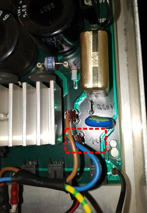

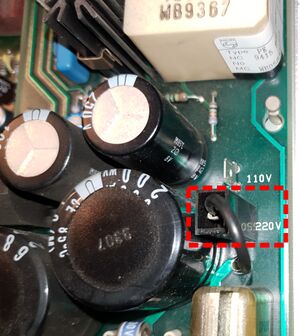

Black wire, 110V position. (Figure 1)
Black wire, 220V position. (Figure 2)

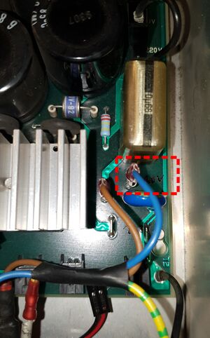

Blue wire, 110V position. (Figure 3)
Blue wire, 220V position. (Figure 4)

To switch the voltage of the power supply between 110V/220V configurations you have to take the following actions:
  • Move the black jumper wire on the "Input Module" PCB, to the correct jumper. (this is marked via silkscreen on the PCB)
    • (Note: the service manual forgets to mention this)
    • See Figure 1 and Figure 2
  • The blue (bl) wire of the cable loom DB1 must be connected to
    • X4106 for 110V operation
    • X4102 for 220V operation
    • You can see the location of these pins on page 63 of the service manual [1]
    • Also see Figure 3 and Figure 4 (note that the PCB from the factory has no text next to these pins, you can only identify them based on relative position)
