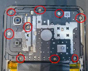

Remove the main board cover
9 Philips head screws cover the main board cover. Remove these (fig. 1) and gently remove the main board cover to expose the board connections.

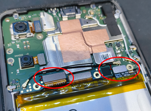

As with all repairs, disconnect the battery (right side) from the main board to avoid any shorting. You can gently bend it away to prevent it reconnecting during repair.
Disconnect the screen (left side)
Now is a good time to test your replacement screen works.
Pull up on the green tape on the battery with your hand to release it from the battery jacket.
If you're experiencing difficulty, feel free to heat the device up from the screen side. This will loosen the battery adhesive.
Take out the battery jacket and place it on the battery once again.
