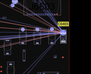

Location of C6465 capacitor on the board view (Figure 1)

  • If 5 V and 0.00 A draw, most likely a 0–1 Ω short to ground on PP3V3_G3H
  • PP3V3_G3H missing due to a short circuit on the input to PP3V3_G3H creation circuit
  • Check for short on PP3V3_G3H with multimeter in diode mode. A good place to check is C6465. If short, inject 3v at 1a to find the short. If a short is found and repaired, ISL 9239 may also be bad due to the short.
