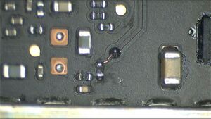

Check R9350
- Examine R9350 (PICCOLO_IUVD) on the board
- Check if R9350 is no longer soldered to the board.
- Look for any missing pad for pin 1 (PPVIN_2V7NAND_LB). Refer to Fig 1 for visual guidance.
- Inspect the area near R9350
- Examine the trace coming out of Terminal 1 of R9350.
- Be cautious about the neighboring via, as it can break the trace.
- Measure the resistance of R9350
- Ensure it is within the specified range.
- Look out for potential trace issues
- Sometimes, the neighboring via can damage the trace, resulting in connectivity issues. Check for broken traces and continuity problems.
- Example of a broken trace (Fixed by running a wire to replace the broken trace)
- Be aware of potential bad probe points, which may look good at a cursory investigation
