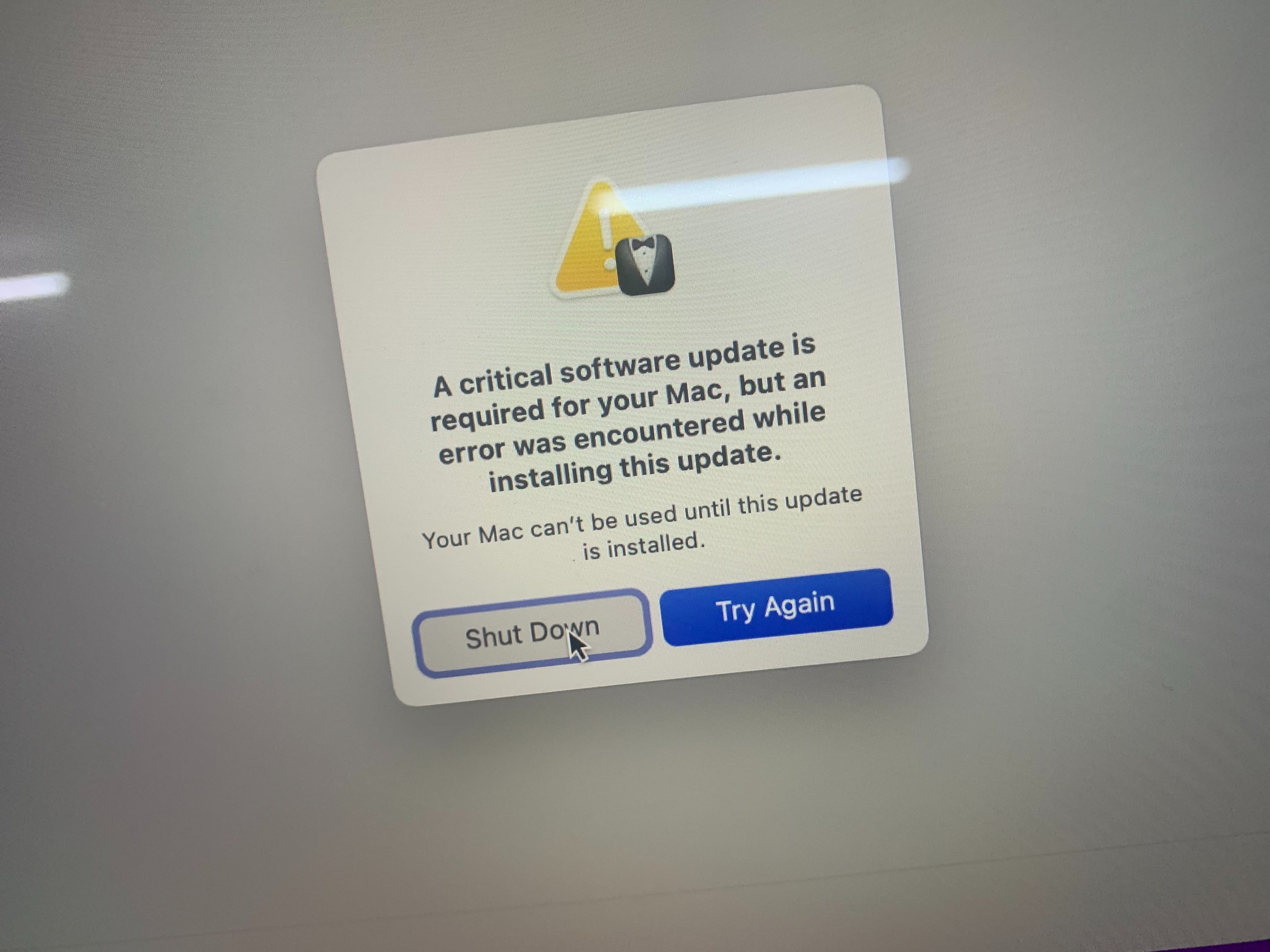

Problem description
Example image (Figure 1) -- No image yet. Help expand this page by uploading it!
Symptoms
  • Symptom 1 (Figure 1)

Diagnostic Steps
  • Bad Touchbar. Unplug Touchbar and try to update again.
  • Bad camera caused by Flexgate, unplug LCD and try to update again on external display.
  • Bad touchID, the T1 chip controls the touchID so in theory a bad touchID could cause this error although unconfirmed.
  • Format drive and install MacOS. If data is required, boot into safe mode by holding shift and transfer data off.
  • If you have tried all of that, then it is most likely a board related issue caused by either bad PMIC or bad T1 chip. Measure all U4200 buck outputs.
  • PP1V8_Sleep3_Buck3 pulled down by corrosion under U4200/T1 PMIC. Fixed by reballing PMIC. This was also causing the Macbook to take a long time to post.
  • Additional Troubleshooting steps - https://logi.wiki/index.php/Critical_Update_Required_Troubleshooting
  • Could be as well a problem with the T1 chip. It will also cause the machine to take a long time to post.
  • Check each pin on Touch Connector J4402 and compare the numbers to OBD.
  • Check each pin on Display connector J4401 and compare the numbers to OBD.
