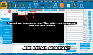

Step 1 – Connect Programmer

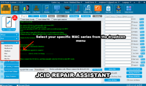

Step 2 – Select Mac Series

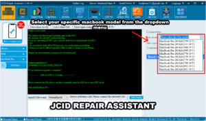

Step 3 – Select Specific Model
Example:
For this guide, select:
MacBook Pro 2019 – A2141
Always ensure:

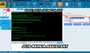

Step 4 – Select Storage Capacity
Choose the storage size you want to program:
- 256GB
- 512GB
- 1TB
- 2TB (if supported)
Example:
- If upgrading to 1TB, select 1TB
- If original device was 512GB, select 512GB
Capacity must match chip configuration.

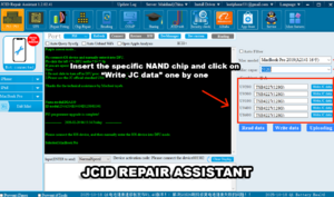

Step 5 – Program NAND Chips
- Insert NAND chip into programmer
- Click Write JC Data
- Wait for programming to complete
- Remove chip
⚠️ After programming each chip:
- Mark it clearly (e.g., U9200, U9100, etc.)
- Use a marker or fine-tip Sharpie
- This prevents position mix-up during soldering
Repeat process for all NAND chips.
