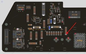

Facing an issue with the MacBook Pro A2337 displaying 5V and a very low current draw of 0.00 to 0.05A on the USB-C meter.
Symptoms
  • MacBook Pro A2337 stuck on 5V with a current draw of 0.00 to 0.05A on the USB-C meter.
  • Not turning on, all voltages missing.

(Figure 1) 820-02016 - PPBUS_AON - C5960

Check voltage on PPBUS_AON
  • Measure voltage on PPBUS_AON by placing your multimeter in DC mode, black probe on ground, and red probe on PPBUS_AON. A suitable measuring point on the 820-02016 logic board is C5960 (Figure 1). Normal voltage should be around 12.60-13.1V.
  • If the voltage is approximately 12.28-12.35V, it may indicate a communication issue between the SOC and PMICs, or corrupt firmware.
  • If the voltage is 0V, proceed to the repair steps for shorted or absent PPBUS_AON voltage.
