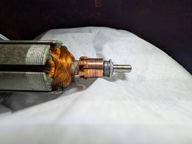

Unscrew the 2x screws from the motor, visible from the end of the motor which was withdrawn from the gearbox. Remove the rear cap of the motor (the end closest to the connection wires), the carbon brushes and the 'commutator' that they touch will be visible under this cover.
Carefully pull the front cap away from the body of the motor, the armature (the rotating part) will also begin to withdraw from the body, you will encounter resistance from the magnets holding the armature in place so it may feel like a spring is holding preventing its removal, apply a little more force and the armature will pull free of the motor body. Place the motor body to one side.
Pay close attention to the motor commutator, which is the segmented brass coloured section on the armature which the carbon brushes could be seen contacting under the rear cover before complete disassembly. There are 7 segments to the commutator which connect to the windings on the armature, between the segments there should be 7 visible gaps.
The gaps between the segments fill up with carbon granules/dust over time, due to the electrically conductive nature of carbon, this creates a short circuit between the segments which the litter robot interprets as excessive load on the motor.
Take a stiff, fine bristled brush and clean the gaps between the commutator segments, wipe longitudinally along the gaps until all the debris is removed. A fine bristled toothbrush or a brass wire brush may be preferable for this task, alternatively a stanley/box cutter/scalpel blade can be used but extreme caution must be taken to prevent damage to the commutator or the thin wires connecting to them. If a piece of sandpaper (~600 grit) is available, wrap this around the commutator windings and gently rotate the armature to 'burnish' it (provide a clean surface for the electrical connection).
Once clean, reassemble in the reverse order, but during insertion of the armature back into the motor body, take particular care to make sure that the armature is not allowed to pull quickly into the body due to the magnets, as this may damage the delicate carbon brushes. Insert it slowly against the magnetic pull, when the commutator reaches the carbon brushes, push the carbon brushes back into their holders and hold with small flat blade screwdrivers or similar, there are springs behind them which apply pressure on to the commutator, then insert the armature fully before allowing the carbon brushes to spring back out on to the commutator.
Once reassembled, reinstall the motor and replace the globe and hood on to the litter robot.
The robot should now cycle without any errors.
