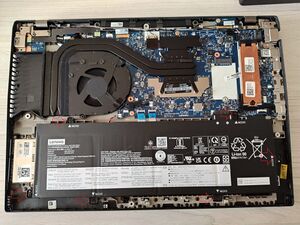

(Figure 2) -- battery disconnecting

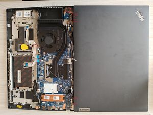

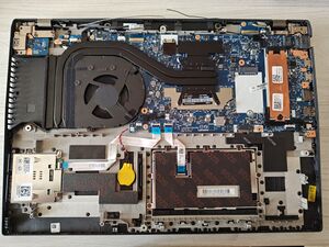

(Figure 3) -- motherboard connectors and screws to remove

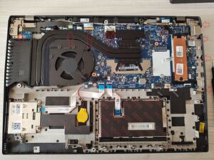

(Figure 4) -- motherboard connectors and screws after disconnecting

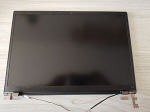

(Figure 5) -- separating the lid

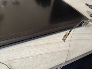

(Figure 7) -- where to start separating screen frame
(Figure 8) - screen frame bottom levered

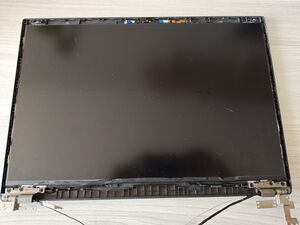

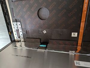

(Figure 9) -- Screen frame removed, notice slightly damaged black tape around the screen

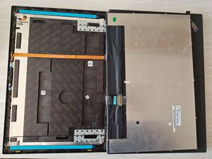

(Figure 10) -- screen connector to disconnect
(Figure 11) -- screen new adhesive tapes in place

WARNING! You might damage the black tape around your old screen due to it being glue to the screen frame (Figure 9) or your entire old LCD screen unit!

  • disconnect battery (Figure 2)
  • disconnect (Figure 3):
    • USB connector for the ease of access
    • camera cable
    • LCD cable
    • Wi-Fi antennas
  • separate the lid by removing hinge screws (Figure 5)
  • separate the frame from the body, starting from bottom right corner (Figure 7 and Figure 8)
  • disconnect the screen connector (Figure 10)
  • attach new LCD screen and make sure it lies properly in place
  • test your screen before applying new LCD tapes (Figure 11)
