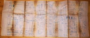

The unit incorporates two circuit boards (see schematic) that each mainly serve one purpose. One is responsible for the heating function and the other is used to control the motor of the magnetic stirring unit.
This makes problems easier to diagnose because (anecdotal) sometimes one function is slightly impaired before more significant issues arise. This gives a fair bit of forewarning to start diagnosing and ultimately repairing the unit.

Schematic
The original schematic for several variants of the original IKA Combimag RET is detailed and contains individual part numbers for reordering a defect component. It also features the layout of both control and supply circuit boards that are in the device.[3] The schematic also features individual values for the passive components and typical voltage profiles in several areas of the circuit.

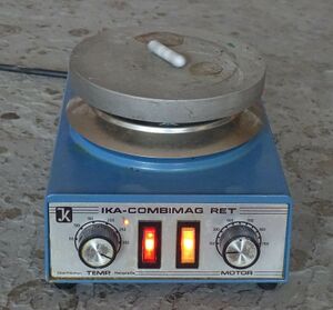

Front of the Combimag RET in operation. A speed of 100 rpm is set for the PTFE stirrer.
