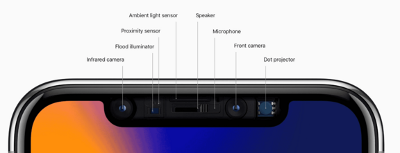

iPhone FaceID sensors and locations
[1]

    • 99% of the time, it is the ear speaker flex. The Flood Illuminator and/or the ALS has liquid damage.
    • The ear speaker flex is paired to the logic board for Face ID.
    • If you want to keep Face ID, you'll need to repair the flex. If Face ID is not important, then you can just replace the flex.
      • To repair the flex, you'll have to desolder the Flood illuminator & clean out all the corrosion, then place them back.
      • If the corrosion is too severe & it damaged the flex, then you'll need to swap the Flood Illuminator and ALS to a new flex, otherwise, you'll lose Face ID.
