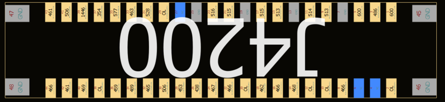

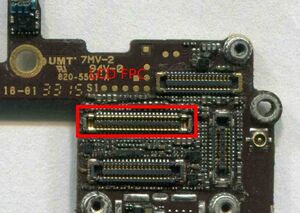

Start by inspecting the FPC connector for any liquid or physical damage.
If everything is fine take diode readings of the display FPC and compare them with the image bellow.

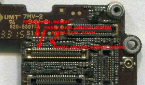

If the diode readings you took are ok next thing to check is if the voltages need to display image are present.
- PP5V7_LCM_AVDDH_CONN
- PN5V7_LCM_MESON_AVDDN_CONN
- PP1V8_LCM_CONN
- PP5V7_MESON_AVDDH_CONN
These voltages can be measured here and only show up with the device turned on.
It is common to have a short circuit on one of these lines, most of these lines also have a filter that acts kinda like a fuse and may open if there is overcurrent.
If the voltages are present, the issue is likely on the MIPI lines. Most of these lines go straight to the CPU through a filter. If every filter is present and testing good, the fault is most likely within the CPU itself.

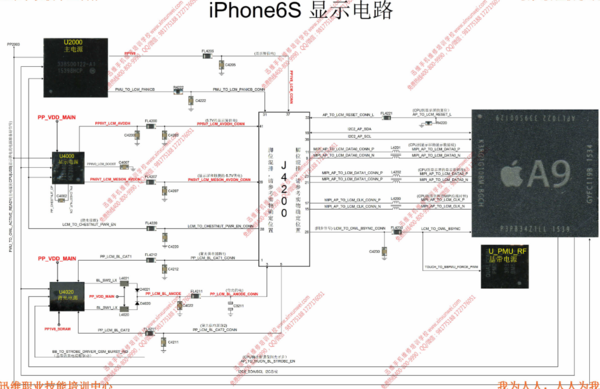

Here is a Block diagram of how the picture circuit works.

If there is a any physical damage to the FPC the solution is to replace it. The best method is to use a hot air station to desolder the old FPC, clean the old solder from the motherboard, apply new solder, align the new FPC, and use the hot air station to solder it. Be careful not to use excessive heat, as you may cause a solder bridge under the motherboard.

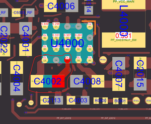

When taking diode readings of the FPC, if you measure a line that should read, for example, 0.500V but get 0.100V or 0.000V, it indicates a short on that line. The best way to trace the short is to inject voltage into the line with a DCPS and use a thermal camera to identify which component heats up. Fallow this guide how to find the short Short Circuits - Repair Basics
If you measure a line that should read 0.500V but get OL (Open Line), it indicates a disconnection in the circuit. To trace the issue, consult the board view to follow the line’s path.

If any of the voltages are missing, use the block diagram to trace where the voltage is generated and replace the chip responsible for creating that voltage. These components are easily available online and are generally easy to find.
