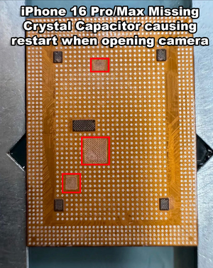

iPhone 16 Pro and Max devices experience repeated camera restarts when opening the Camera app.
The root cause is a damaged or missing crystal capacitor located under the CPU.
This fault cannot be resolved by software restore or peripheral replacement. The issue requires component-level repair under the CPU.

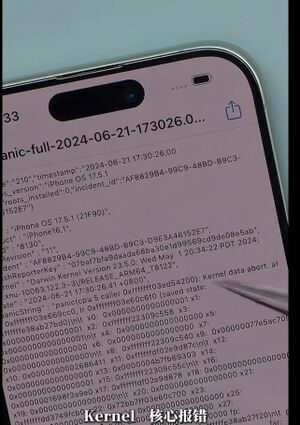

Diagnostic Steps
- Confirm panic logs
- Look for kernel panic related to camera or standby
- Reproduce issue
- Open Camera app → immediate reboot

- Board inspection
- Inspect CPU underside area for missing/damaged capacitors

- Locate faulty/missing crystal capacitor(s)
- Remove damaged capacitor carefully

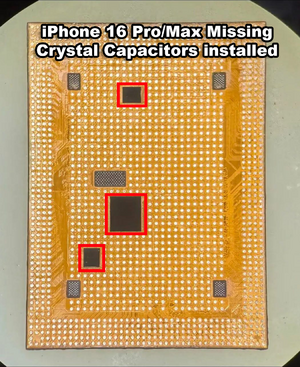

- Clean pads and inspect traces
- Install replacement capacitor from donor CPU
- Reassemble and test
