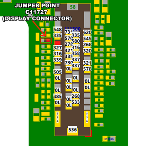

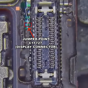

  1. Locate IO_AP_TOUCH_BSYNC1 line on display connector (J11800) and measure its diode value.
  2. If line shows OL, it’s disconnected.
  3. If line shows 0.000V or close to GND, it’s shorted internally to CPU.
Jumper location on the display connector [J11800] - figure 1

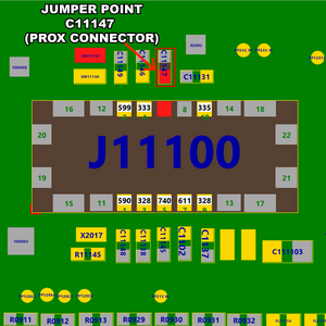

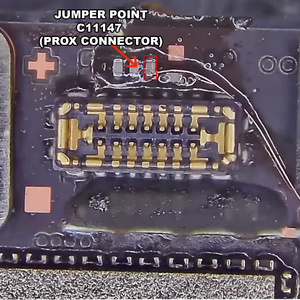

  1. Locate the capacitor (C11727) connected to IO_AP_TOUCH_BSYNC1 line.
  2. Find IO_AOP_TO_ALS_BSYNC2_CONN on the front prox connector (C11147) (see fig. 2)
  3. Run a jumper wire from that point on the front prox connector to the output side of the removed filter pad.
  4. Clean up, reassemble, and test — Touch should now be restored.
Jumper location on the prox connector [J11100] - figure 2

  1. Disconnect the IO_AP_TOUCH_BSYNC1 pad on the display connector to isolate the short.
  2. Confirm that the line is no longer shorted beyond the capacitor.
  3. Run a jumper wire from IO_AOP_TO_ALS_BSYNC2_CONN on the Front Prox Flex connector (J11100) to the display connector (J11800). (see fig. 1)
  4. Clean up and test — Touch should be restored.
Jumper location on the display connector - BoardView
Jumper point on the prox flex connector - Boardview
