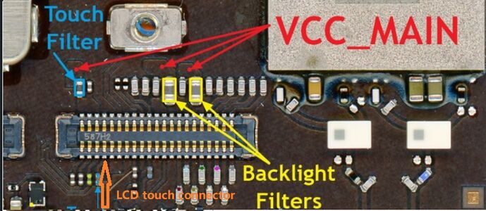

If there is no backlight after a screen replacement, the screen was most likely connected/disconnected with the battery plugged into the board. This can cause one or both of the backlight filters above one of the display connectors to blow. Replacement of these components will often resolve backlight issues, bellow is a guide on diagnosing the backlight circuit.
Diagnostic Steps
The first step is check if both backlight filter are ok, with your multimeter in continuity mode check the filter in the image bellow the must have continuity across.
The backlight filters are the most common issue, these filters are cheap and can be found online easily.

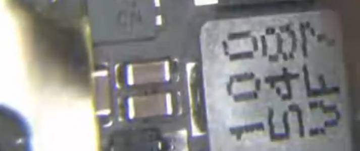

If the backlight filters are ok the next thing to check is for shorts on the capacitors related to the backlight circuit these caps are used as decoupling capacitor do only one side of thee is connected to GND with your multimeter in continuity mode place a probe on ground and probe the capacitors you can have both side beeping.
After checking for shorts next thing to check is the Diodes check if they have any physcial damage like in the picture bellow.
