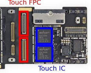

Inspect the 2 touch connectors for any physical damage.

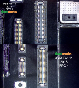

Take diode readings of the FPC and compare them with the 2018 Version the touch circuits are very similiar they even use the same touch ICs.
iPad Pro 11" 2018 Diode Values to Compare (THX GeekMatics)
Check every filter connected to the touch connectors.
Check for shorts around both Touch ICs(BCM15900B0).

When taking diode readings of the FPC, if you measure a line that should read, for example, 0.500V but get 0.100V or 0.000V, it indicates a short on that line. The best way to trace the short is to inject voltage into the line with a DCPS and use a thermal camera to identify which component heats up.
If you measure a line that should read 0.500V but get OL (Open Line), it indicates a disconnection in the circuit. To trace the issue, consult the board view to follow the line’s path.
If a filter connected to the touch connectors is open, replace it with one matching the same specifications or source it from a donor board.
If there is a short on a component near the Touch IC, inject voltage with a DCPS and use a thermal camera to identify which component is heating up.
If none of the above steps resolve the no-touch issue, the next step is to reball or replace both Touch ICs(BCM15900B0) these chips are used in many iPads so they are easy to find.
