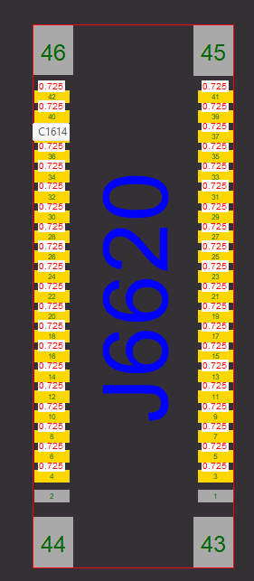

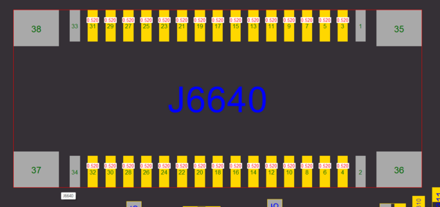

Take diode readings of the Touch FPCs and compare them with the image bellow.
J6620 Diode Readings
J6640 Diode Readings

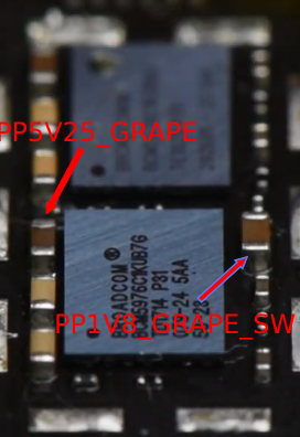

If everything is ok the next step is to check if the touch ICs(Cumulus) have the required voltages to work.
The main voltages required for this circuit to work are:
  • PP5V25_GRAPE
  • PP1V8_GRAPE_SW
These voltages can be measured here :
iPad Air 1 Touch Voltages

When taking diode readings of the FPC, if you measure a line that should read, for example, 0.500V but get 0.100V or 0.000V, it indicates a short on that line. The best way to trace the short is to inject voltage into the line with a DCPS and use a thermal camera to identify which component heats up.
If you measure a line that should read 0.500V but get OL (Open Line), it indicates a disconnection in the circuit. To trace the issue, consult the board view to follow the line’s path.
If PP5V25_GRAPE it is probably due to a bad PMIC(8100) since this line comes from there, this chip is glued to the PCB with underfill and it not recomend to replace without practice.

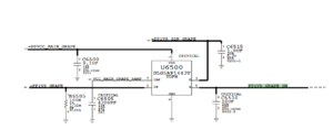

If PP1V8_GRAPE_SW it is probably due to a bad U6500 since this line comes from there.
iPad Air 1 U6500
If the required voltages are present and the diode readings are ok the next step is to replace both Cumulus ICs these chips is present on many devices like the 6 and 6 Plus, iPad Mini 1, iPad Mini 2, iPad Mini 3, iPad Mini 4 and iPad 5, so if you have any of these devices you harvest from a donor board, or you can buy the chip new online its very easy to find the reference is BCM5976.
To replace the your hot air station to desolder them, then add low melt solder to the pads on the motherboard after that clean the solder leaving a flat surface to solder the new chip. Be careful with heat since the the Touch FPCs are near by, i recommend covering them with kapton tape.
