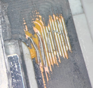

After making the hole you will see the cable is ripped in this section.

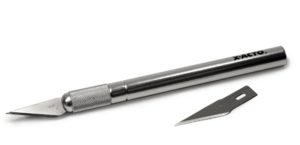

To repair the cable we will need to expose the coper traces,use a X-Ato blade like this one.
Scrape the cable very gently until it looks like this.
After scraping we need to do a few jumpers like the image bellow.
Avoid using to much flux because if you do it will infiltrate the LCD and you will have stains on LCD
After doing the jumps you can place a small piece of kapton tape over it.
After doing this test the LCD and you should have it back working like normal.
