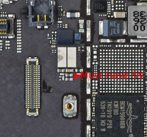

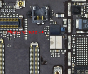

Start by checking if the 5V from the charger are actually arriving to the main board measure this filter it should have around 5V
If there is not voltage here with the charger plugged in the replace the charging port flex.

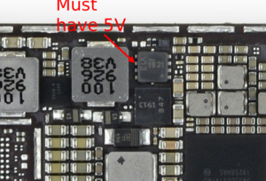

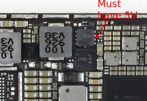

Next check if the voltage is arriving to this mosfet
If there is no voltage there or you have less them 5V for example 2V it means that the filters F3700 and F3750 are faulty and must be replaced.
Next check if the mosfet is working the output is the expected 5V if its not Q8550, DZ8550 or R8550 may be faulty.
