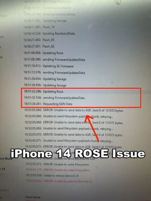

iPhone 14 fails to restore and throws Error 9 during iTunes / 3uTools restore. The restore process may begin normally but fails mid-way.
Upon inspecting the restore logs, communication failure is traced to the ROSE IC, confirming a hardware fault.
This issue requires board-level repair and cannot be resolved via software.

- Restore logs indicate ROSE communication failure

- Review restore logs
- Look for ROSE-related errors

Once logs confirm ROSE fault → proceed to board repair.
