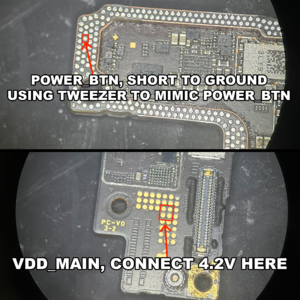

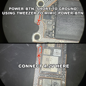

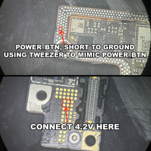

  1. Power Setup Connect 4.2V from DC Power Supply (DCPS) to: Positive lead → VDD_MAIN/VDD_BATT pad on lower board. Negative lead → Ground pad.
  2. Locate Power Button Pin Identify the Power Button pin on the interposer connector of the lower board.
  3. Simulate Power Press Use tweezers to short the Power Button pin to Ground momentarily. This mimics pressing the physical button.
  4. Confirm Boot current draw on DCPS: If phone enters OS, lower layer repair is successful.
