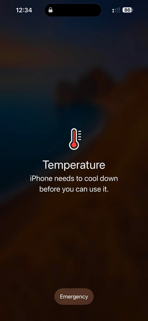

iPhone 16 Pro / 16 Pro Max displays a “Temperature Too High” warning immediately on boot or shortly after connecting a charger, even though the device is physically cool and shows no real thermal rise.
iPhone 16 Pro/Max Temp. Warning
Symptoms
  • “Temperature Too High” warning on screen
  • Device refuses to charge or throttles charging
  • Issue appears instantly, even on a cold device
  • No abnormal current draw on DCPS
  • No actual heating of CPU, PMIC, or battery

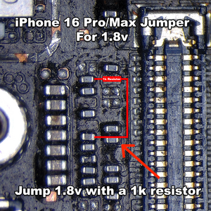

Diagnostic Steps
  1. Confirm device is physically cool
  2. Measure current draw (should be normal / idle)
  3. Measure voltage at gpio_aop_from_baro_int_l
    • ❌ ~0.8–0.9 V → fault confirmed
  4. Locate pp1v8_s2_dock_conn
  5. Verify donor rail is clean and stable before proceeding
Repair Steps
  1. Disconnect battery
  2. Identify gpio_aop_from_baro_int_l
  3. Identify pp1v8_s2_dock_conn
  4. Solder a 1 kΩ resistor in series with a fine jumper wire
  5. Connect:
    • One side of resistor → 1.8 V source
    • Other side → affected dock FPC signal pad
  6. Secure jumper to prevent movement or shorts
  7. Reconnect battery and power on device
