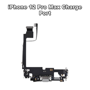

  • A faulty charging port (dock flex) affecting temperature sensor readings, or
  • Separation / cracked solder joints between the AP and RF sandwich layers, interrupting RF temperature sensor lines.
iPhone 12 PM - Charge Port Flex

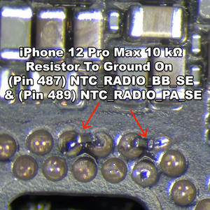

iPhone 12 PM - Resistors to temporary bypass Temperature Warning

Fix 1: Replace Charge Port (Recommended First Step)
  1. Replace the charge port with a known-good OEM or high-quality part
  2. Reassemble and test
✅ If warning disappears → fault confirmed in dock flex

Fix 3: Data Recovery Only (Temporary / Bypass Methods)
⚠️ These methods are not permanent repairs and are intended only for data recovery.
Option A: Known-Good Bottom Board
  • Use a known-good bottom (RF) board in an iSocket jig
  • Allows temporary boot for data access
Option B: Temperature Sensor Bypass
Bypass the RF temperature readings by adding a 10 kΩ resistor to ground on the following lines:
  • Pin 487 – NTC_RADIO_BB_SE
  • Pin 489 – NTC_RADIO_PA_SE
This forces valid temperature values and clears the warning long enough to:
  • Boot the device
  • Back up data
