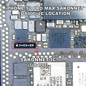

An iPhone 12 Pro Max presents with no sound from the bottom loudspeaker and no vibration feedback.
Standard checks such as speaker replacement and amplifier IC replacement fail to resolve the issue.

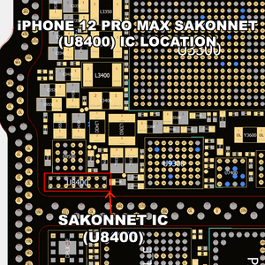

Root cause: a faulty Sakkonet IC, resulting in loss of both audio output at the bottom speaker and haptic feedback.
Symptoms
- No sound from the bottom loudspeaker (earpiece works normally).
- Vibration motor not working — no haptic feedback or alerts.
- Speaker and taptic engine test fail in diagnostics.
- Audio ICs and lines appear normal under diode mode check.
- Replacing both audio amplifier ICs does not fix the issue.
- Issue resolves completely after replacing the Sakkonet (U8400) IC.

4. Sakonnet IC Replacement
- Replace the Sakonnet IC (U8400) using controlled temperature.
- Clean the area, reball the IC, and ensure all power rails are intact.

3. Sakonnet IC Removal
- Using flux, heat Sakonnet IC area.
- Gently lift the Sakonnet IC (U8400) once solder is molten.
- Clean pads on the board thoroughly with solder wick and flux.
4. Reball & Reinstallation
- Reball the donor Sakonnet IC with fresh solder balls.
- Align precisely to the board pad array under microscope.
- Reflow and Install IC.
- Allow to cool and clean the area.
