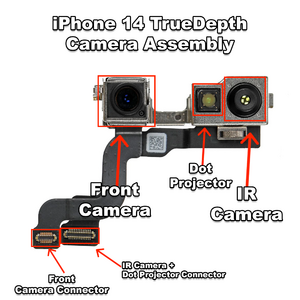

iPhone 14 TrueDepth Camera Assembly
Problem description
iPhone 14 continuously bootloops. The issue is traced to a shorted or malfunctioning front IR camera flex within the TrueDepth assembly, which causes abnormal line behavior on the front camera rail.

Solution
Replace the front camera/IR camera assembly (TrueDepth module).

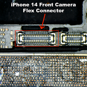

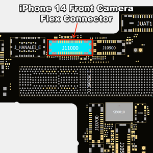

iPhone 14 Front Camera Flex - Boardview

  3. Isolation Test
    • Unplug the front camera/IR flex → reconnect battery and observe behavior.
    • If phone now boots fully into iOS, fault confirmed in front camera/IR module.
  4. Substitute Test (if available)
    • Connect known-good front camera assembly and check if auto-boot and bootloop are resolved.

  1. Power off and disconnect battery.
  2. Locate front camera/TrueDepth assembly flex.
  3. Disconnect front camera flex and test boot with DCPS or charger.
  4. Once confirmed device boots normally, replace the front camera/IR module.
  5. Reassemble, connect battery, and verify stable boot.
