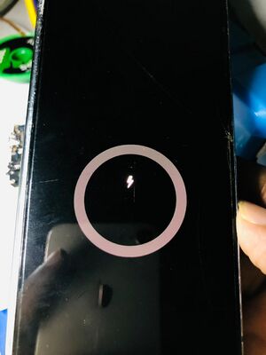

Samsung Z Fold 4 displays the charging animation but never boots. Acts as if charging but battery percentage does not increase.
Z Fold 4 5G - Fake Charging

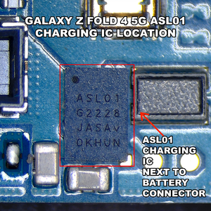

Z Fold 4 5G - ASL01 Charging IC
Symptoms
  • Shows charging symbol only
  • Stays stuck on charging logo
  • Battery percentage does not increase
  • Phone does not power on normally
  • V_BATT line measuring 0 Ω (dead short)

The failure is caused by a short on the V_BATT power rail, usually due to a failed ASL01 power IC.
Removing the IC clears the short; replacing it resolves fake charging permanently.

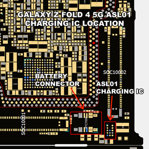

Z Fold 4 5G - ASL01 IC Location On BoardView

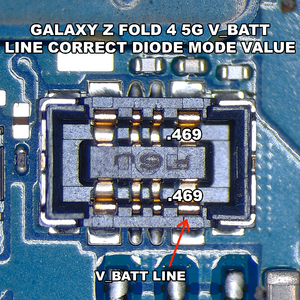

2. Diode Mode – V_BATT Rail Check
  • Probe the V_BATT test point / capacitor bank near the FPC connectors.
  • Expected normal reading: typically in the hundreds of kΩ or >1MΩ.
  • Faulty board reading : 0.09 Ω → confirmed short.

  • Move to boardview/diagram → V_BATT rail maps to ASL01 Charging IC (Located right next to the Battery Connector FPC).
4. Confirm Shorted IC
  • Apply rosin + re-inject voltage.
  • ASL01 IC heats up → confirmed bad component.

1. Remove the Faulty ASL01 IC
  • Mask surrounding components with high temperature tape.
  • Apply hot air.
  • Gently lift the ASL01 IC.
2. Re-Test the V_BATT Rail
  • Measure at same point as initial short.
  • After IC removal: reading becomes 19 MΩ.
  • This confirms the short is fully cleared.

4. Final Measurement
  • After reinstallation, check V_BATT again:
    • Reading becomes 2.16 kΩ / .469V (normal range from reference).
