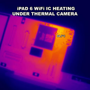

4. Inspect Charging IC Region
- Check under thermal camera/rosin flux for a bad Charging IC.

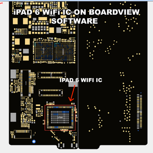

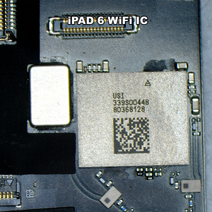

5. Check WiFi Section
- Check under thermal camera/rosin flux for a shorted WiFi IC.

Based on DCPS + thermal/rosin method:
- Shorted capacitor? → Replace
- Hot WiFi chip? → Replace

- Replace WiFi IC
