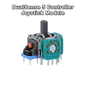

Figure 2 -- DualSense 5 Controller Joystick Module

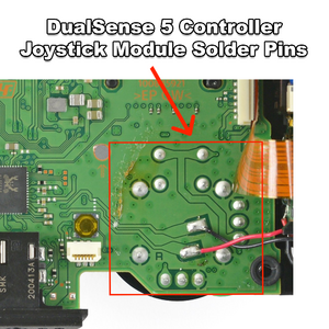

Figure 3 -- DualSense 5 Controller Joystick Solder Points

  3. Check Drift Severity
    • Slight, inconsistent drift → likely contamination.
    • Strong, constant drift in one direction → worn potentiometer.
    • Drift on both axes → joystick module failure.
  4. Inspect for Physical Wear
    • Rotate and press the stick.
    • Note:
      • Loose feel
      • Grinding or resistance
      • Stick not returning to center
  5. Decide Repair Path
    • Minor drift → cleaning attempt.
    • Persistent drift → joystick module replacement.

Repair Option 2: Joystick Module Replacement (Permanent Fix)
  1. Fully disassemble the controller.
  2. Remove battery and internal shields.
  3. Expose the joystick module PCB.
  4. Desolder the joystick module:
    • Add low melt solder to joystick solder points (See Fig. 3)
    • Heat evenly
    • Avoid lifting pads
  5. Clean solder pads thoroughly.
  6. Install a new joystick module (OEM or Hall-effect upgrade).
  7. Solder all anchor and signal pins securely.
  8. Inspect joints under magnification.
  9. Reassemble controller.
  10. Test analog stick response.
✅ This is the recommended long-term fix for stick drift.
