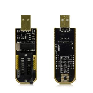

Needs equipment Soldering Iron, CH341A Programmer, Jumper Wire

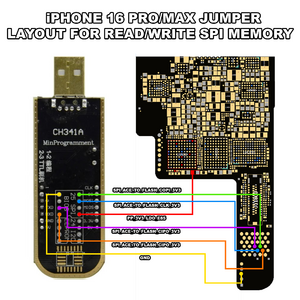

This guide documents how to access and modify ACE EEPROM data in-circuit on iPhone 16 Pro and Pro Max, avoiding the need to split the sandwich logic board.
CH341A Programmer

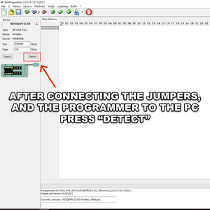

  1. Disconnect all power from the board
  2. Solder jumpers from CH341A to ACE SPI points
  3. Connect CH341A to PC

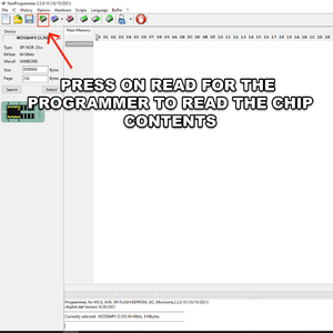

  4. Open CH341A Programmer
  5. Press Detect
  6. Click Read

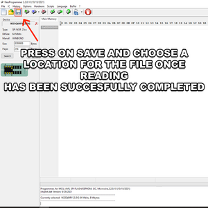

  7. Click Save. (Save at least two copies of the dump)
  8. Read again and compare files for consistency

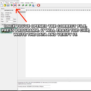

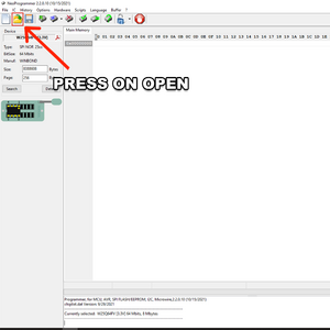

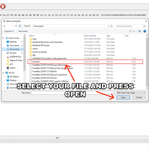

Write / Restore Procedure
  1. Click Open
  2. Select your file and press open
  3. Click Program
  4. Confirm verification passes with no errors
After Programming
  1. Disconnect CH341A
  2. Remove jumper wires
  3. Inspect pads for bridges
  4. Reconnect battery
  5. Power on device and confirm charging works.
